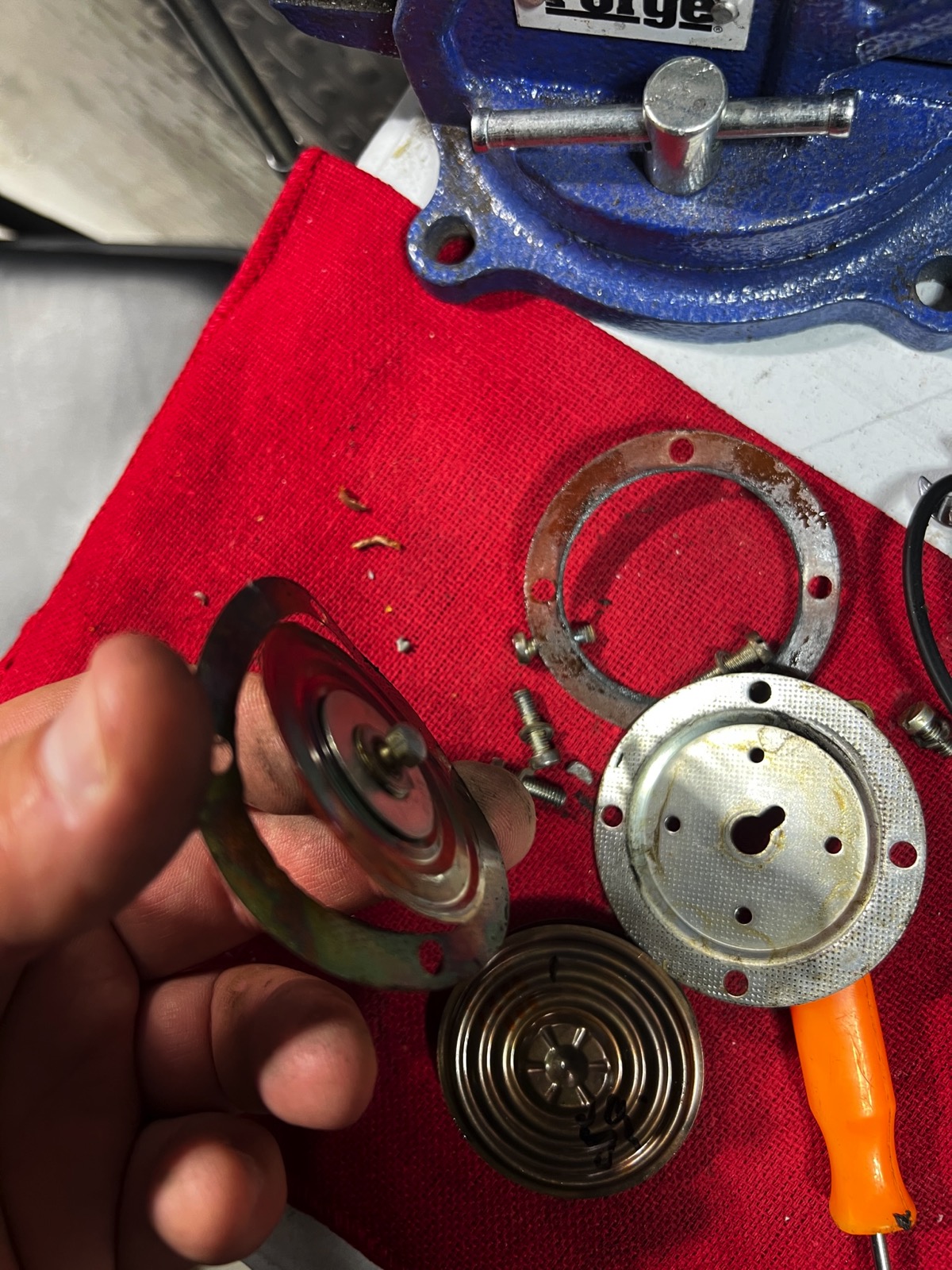

Good news. I ordered Tangerine's MPS rebuild kit. While waiting for its arrival, I tested mine for Vacuum. Zilch.
Took it apart (it appears to have been rebuilt before) and take a look at the diaphragm. A total loss.
So Thank you for pointing me in this direction, I think this will be a HUGE step to getting it running. I also appear to have had the wrong Head temp sensor, so I sourced what I believe is the proper one and will install this weekend, hopefully in conjunction with a rebuilt MPS.
Ill keep you posted. Attached Image

JeffBowlsby   In your first post you said your “MPS holds vacu...   Sep 15 2022, 08:46 PM
Robarabian   Yeah, I didn't give it long enough when I test...   Sep 15 2022, 09:36 PM
