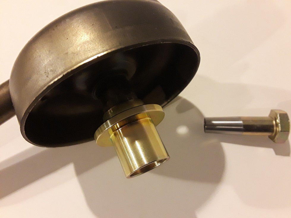

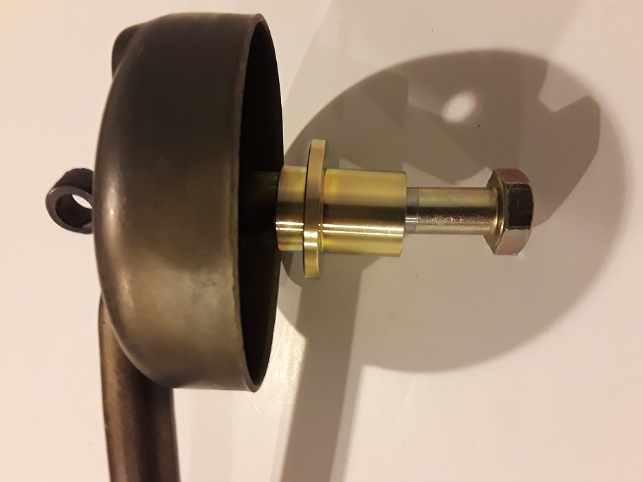

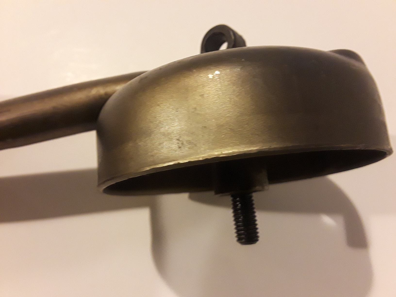

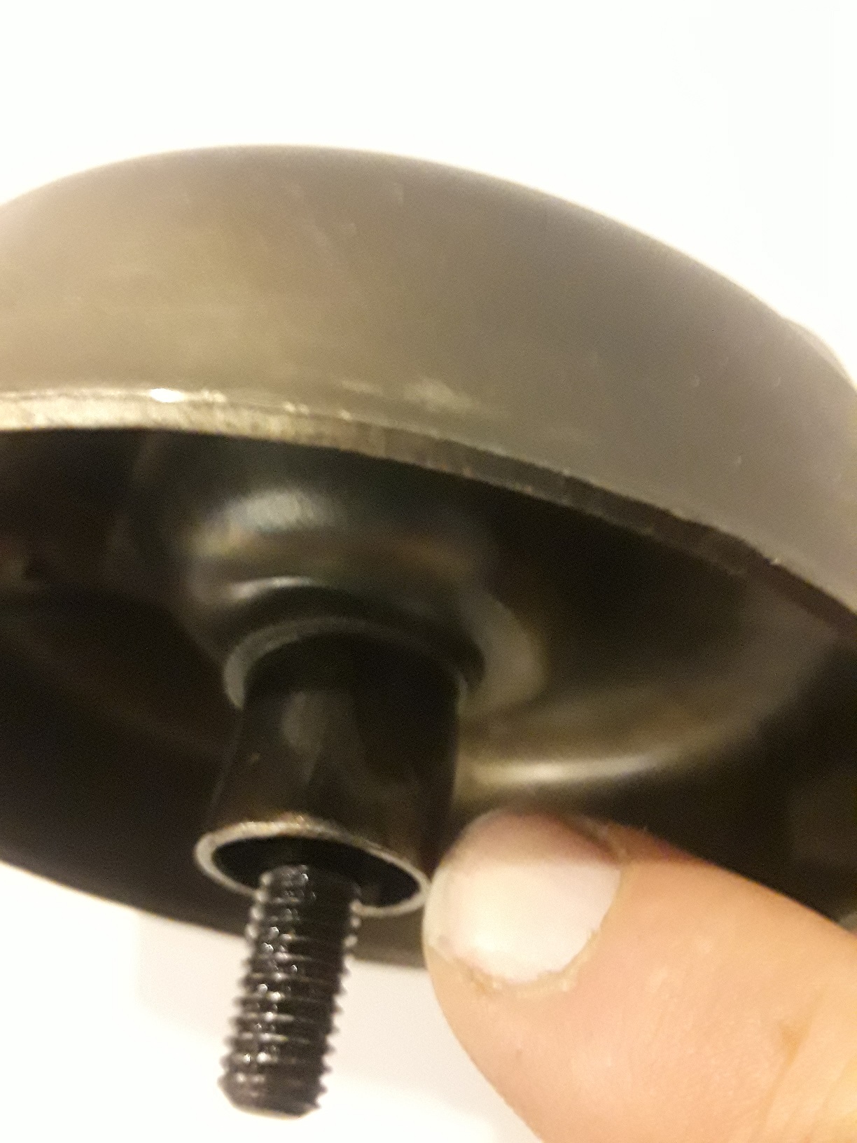

So a few folks have asked for more detailed instructions than the one page install sheet provided. (IMG:style_emoticons/default/biggrin.gif)
Rather than create the next War & Peace I figure a few photo's cant hurt (IMG:style_emoticons/default/happy11.gif)
Below is the actual sump removed from the case (not necessary for installation)
This way you will more clearly see the Pick-up tube, which is extended with a piece in the kit.
The issue is that that tube is a stamped part that can need a bit of love to allow the fit of the extension.
Ive found that the application of some slight filing or sanding at the bottom mil or two of that tube will allow the tight fit necessary.
