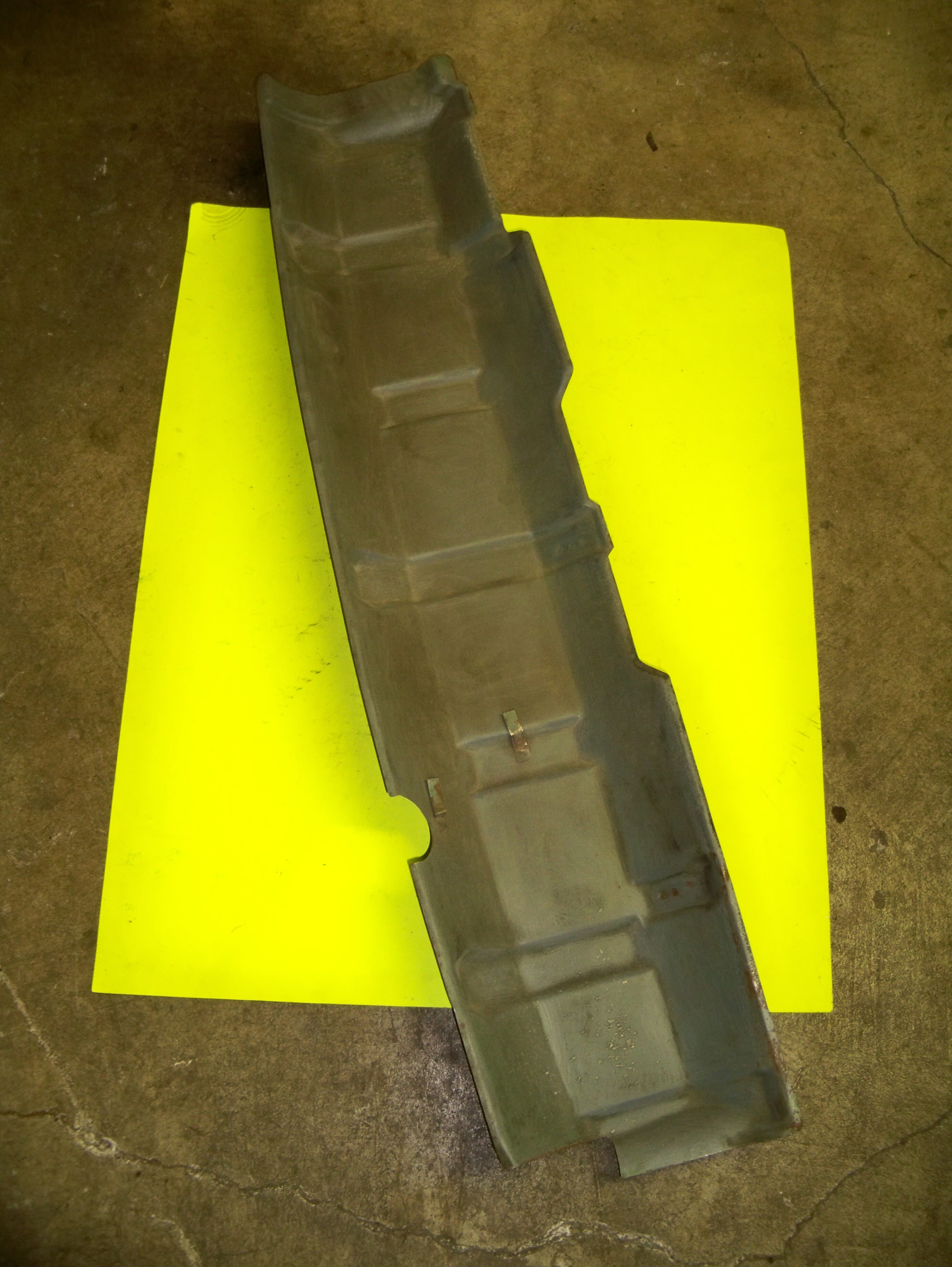

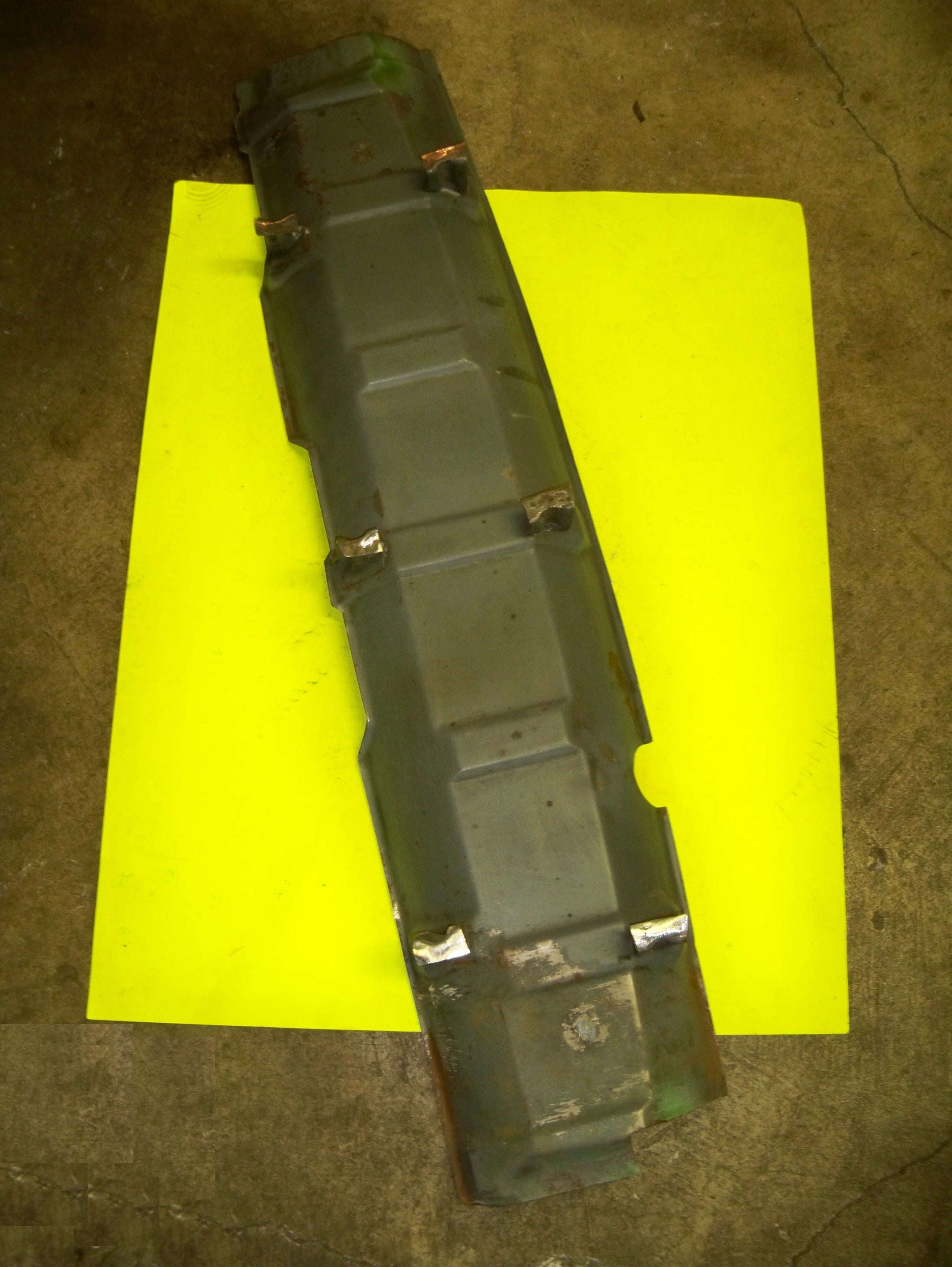

Mine is missing and what is left behind looks like someone took a pair of pliers and yanked it off during a pit stop.
Is this part available just as a shield or part of a trunk patch? I looked at a couple of suppliers but I am not finding anything.

My mistake down to the last one. (IMG:style_emoticons/default/rolleyes.gif)
here is example of late, conditing is similar.
LMK
