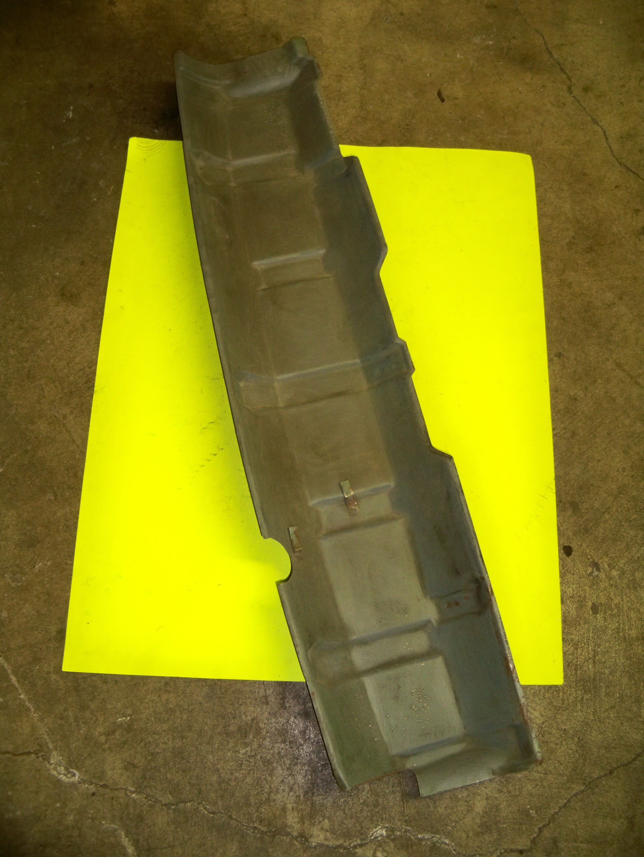

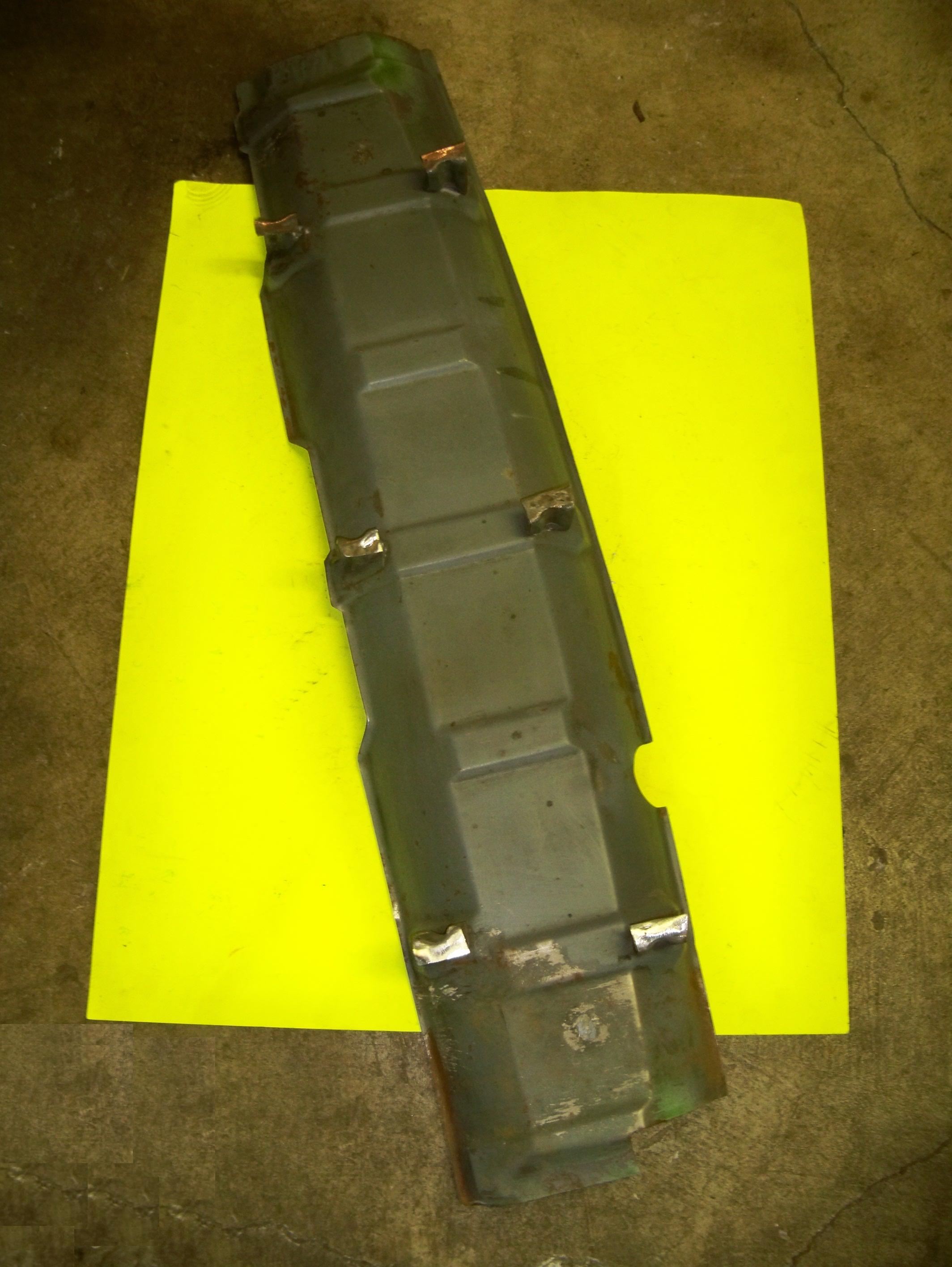

Click to view attachmentClick to view attachmenthere is example of late, conditing is similar.
LMK
dr914@autoatlanta.com
Sep 30 2022, 01:34 PM
actually they had 91450159410 superseded by 59411, the 914-6 was screwed in, the fours were welded in

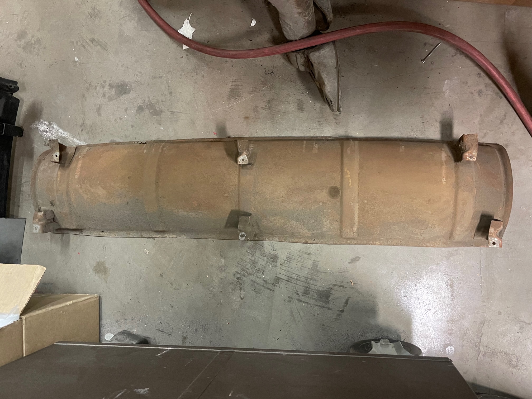

I didn't realize that the early and late are actually different stampings. The early one is rounder in profile and straight at the edges, no cutout bits like the late one.
Here's the 1970 early removable one
Click to view attachmentClick to view attachmentand the late one on a fairly early 72

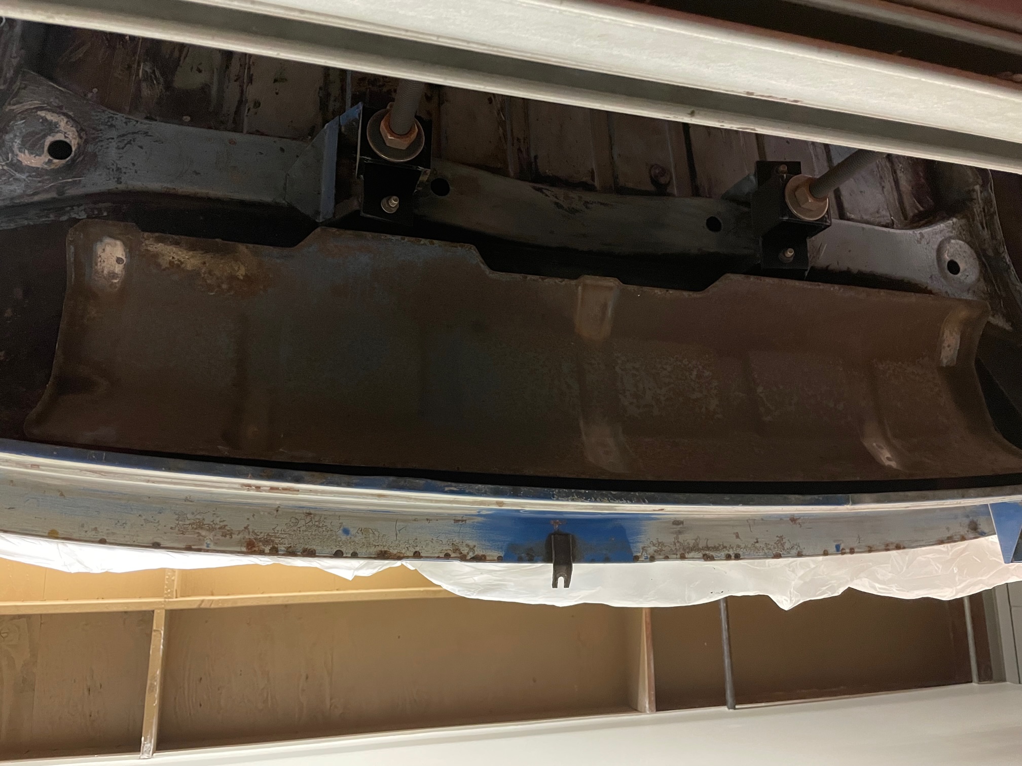

Here's my 73 muffler shield bolt-on modification. Two new brackets that bolt through the shield.
bkrantz
Mar 4 2023, 10:05 PM
Brackets welded to the trunk floor.
bkrantz
Mar 4 2023, 10:07 PM
Shield bolted on. All this was before I did paint. I eventually had the shield powder-coated with high-temp powder.
