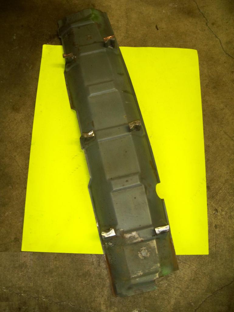

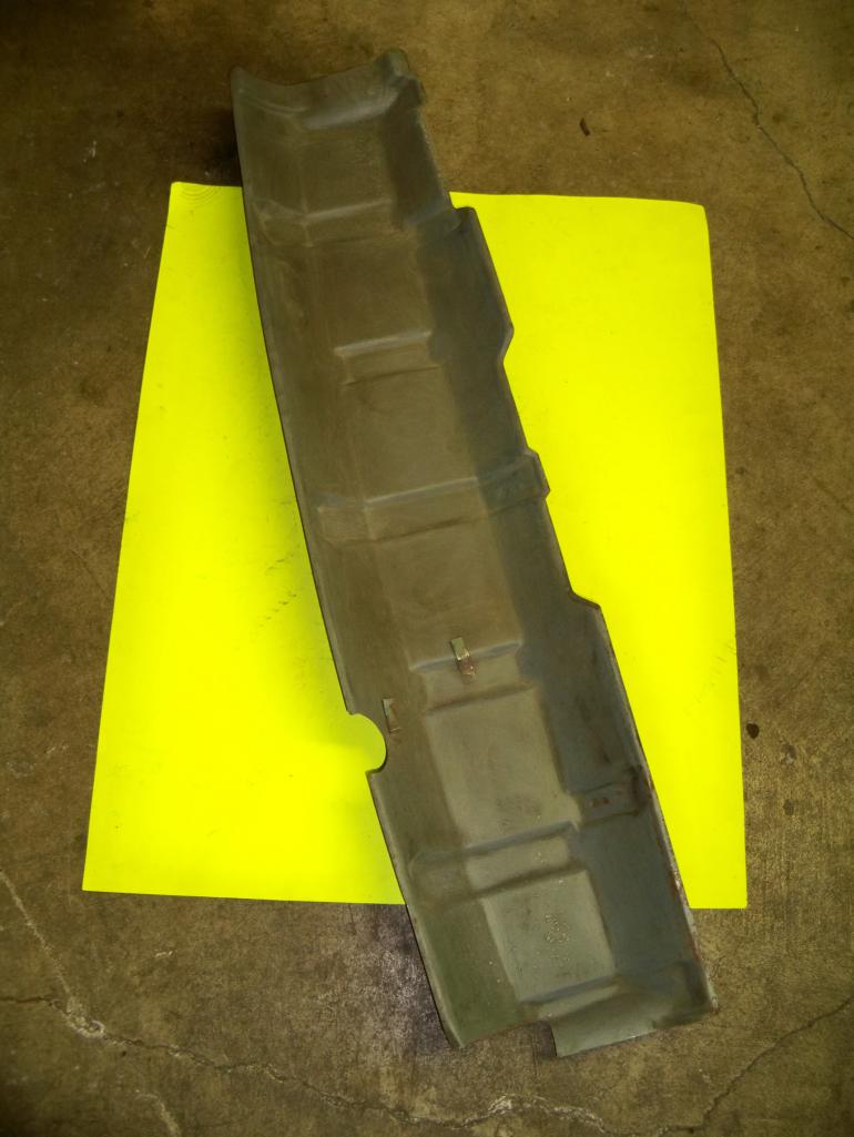

914werke
post Sep 30 2022, 11:59 AM
Posts: 11,351
Joined: 22-March 03
From: USofA
Member No.: 453
My mistake down to the last one. (IMG:style_emoticons/default/rolleyes.gif)
here is example of late, conditing is similar.
LMK
