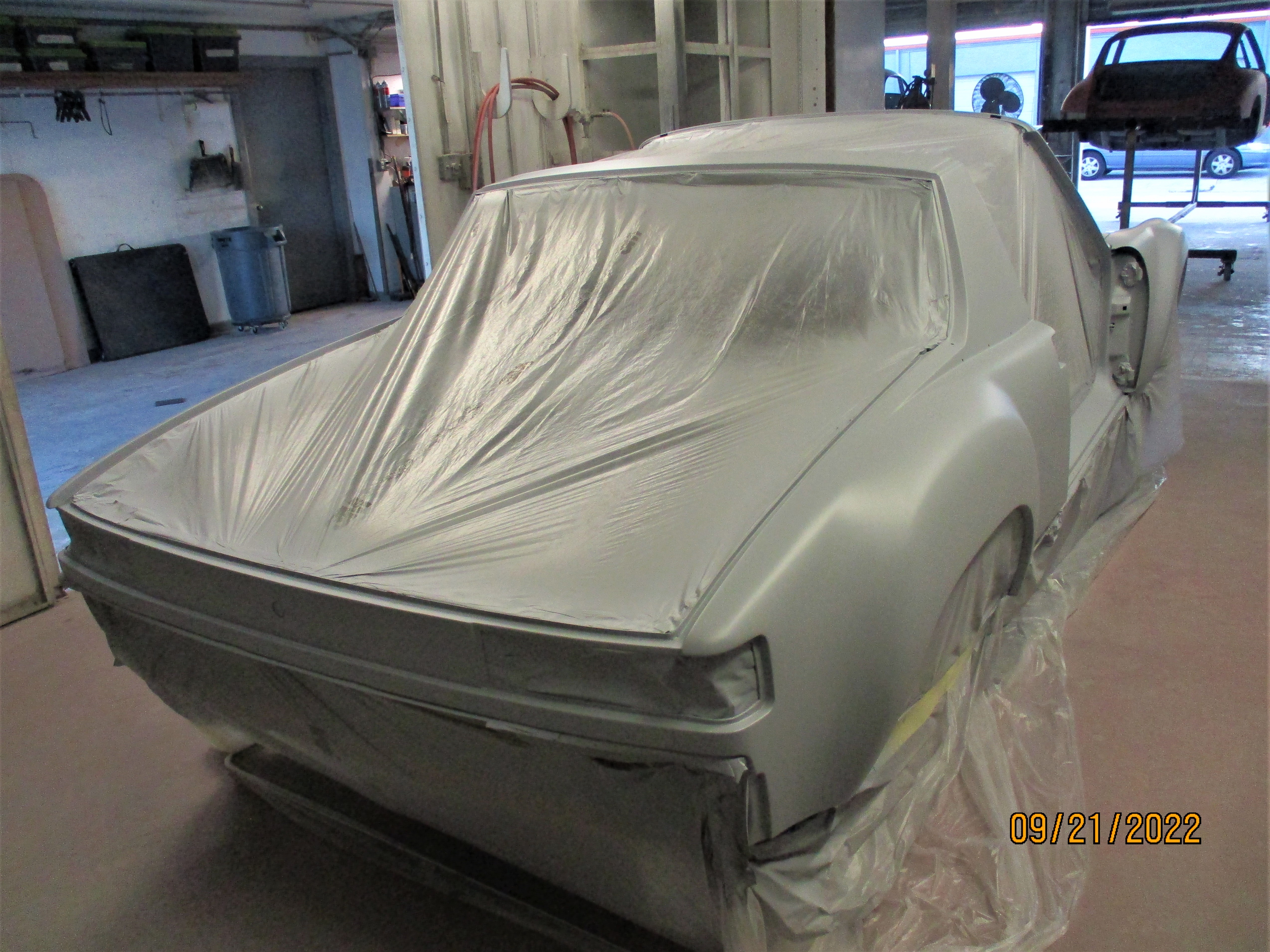

Slower pace of work this summer, but now much closer to paint. Final fitment of all panels and mucho blocking time... color cards sprayed and approved. Next post it'll be orange again.
