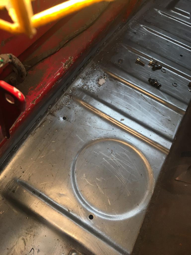

Mine is missing and what is left behind looks like someone took a pair of pliers and yanked it off during a pit stop.
Is this part available just as a shield or part of a trunk patch? I looked at a couple of suppliers but I am not finding anything.

Here is what I did (lower part of this post):
http://www.914world.com/bbs2/index.php?s=&...t&p=2910494
Missing picture in the thread, holes in the trunk done using template. Shield bolts on perfectly.

bkrantz   Here's my 73 muffler shield bolt-on modificati...   Mar 4 2023, 10:04 PM
bkrantz   Brackets welded to the trunk floor.   Mar 4 2023, 10:05 PM
bkrantz   Shield bolted on. All this was before I did paint...   Mar 4 2023, 10:07 PM
