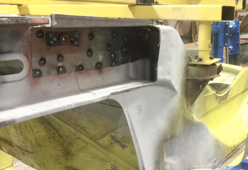

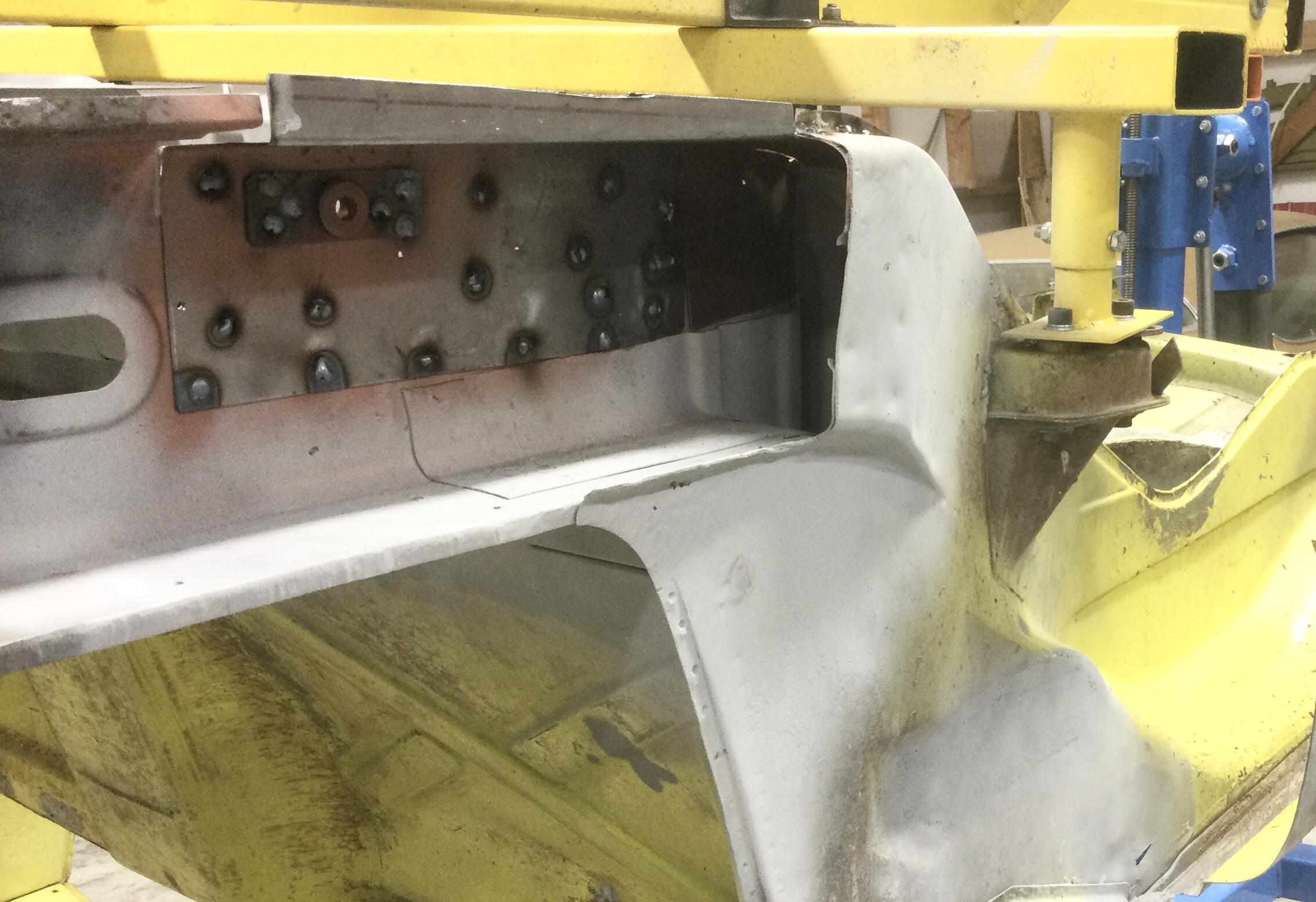

Alain V.   Well, after getting sidetracked by work and other ...   Jul 17 2022, 07:39 PM
Alain V.   RE: 72 rustoration / subaru 6cyl project in Kansas   Jul 17 2022, 07:40 PM
76-914   Earlier I missed your comment on having pinholes g...   Jul 19 2022, 07:46 AM
Alain V.   Earlier I missed your comment on having pinholes ...   Aug 28 2022, 08:45 PM
