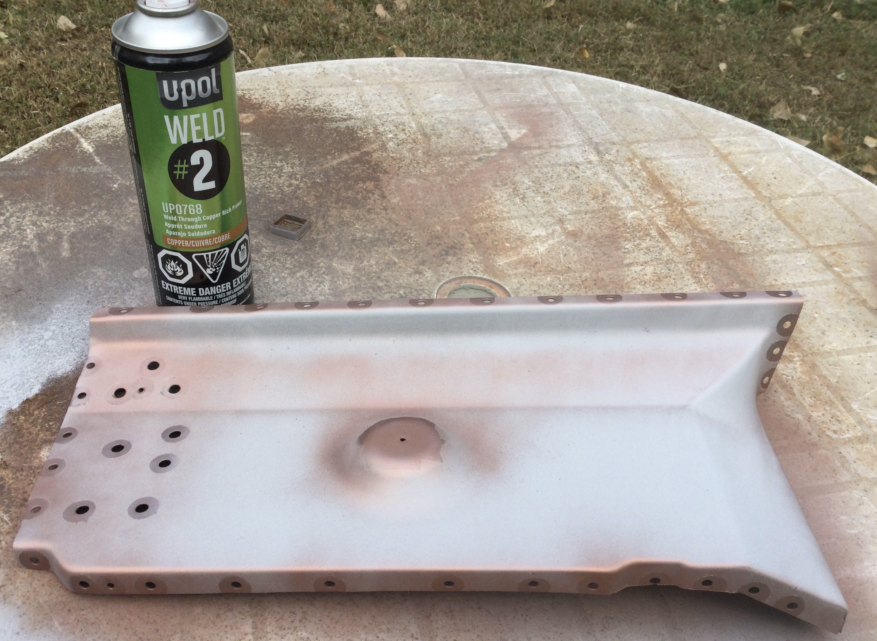

Alain V.   Thanks for the tip about using copper. Not too mu...   Feb 13 2022, 05:12 PM
Alain V.   Welding it in.   Feb 13 2022, 05:13 PM

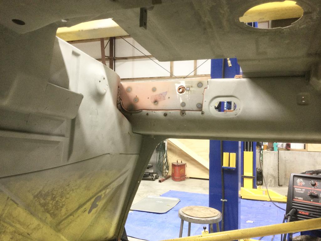

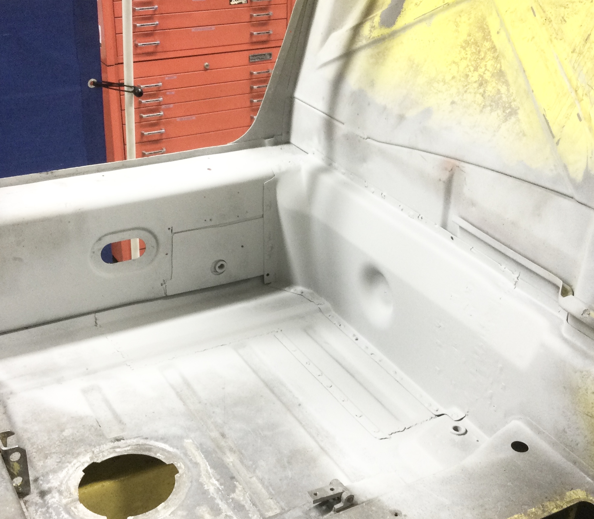

Alain V.   Well, I have made a little progress.   Oct 16 2022, 06:04 PM
Alain V.   RE: 72 rustoration / subaru 6cyl project in Kansas   Oct 16 2022, 06:05 PM
Alain V.   RE: 72 rustoration / subaru 6cyl project in Kansas   Oct 16 2022, 06:09 PM
Alain V.   RE: 72 rustoration / subaru 6cyl project in Kansas   Oct 16 2022, 06:10 PM
tygaboy   That's a nice, tidy repair! You're doi...   Oct 17 2022, 08:40 AM
