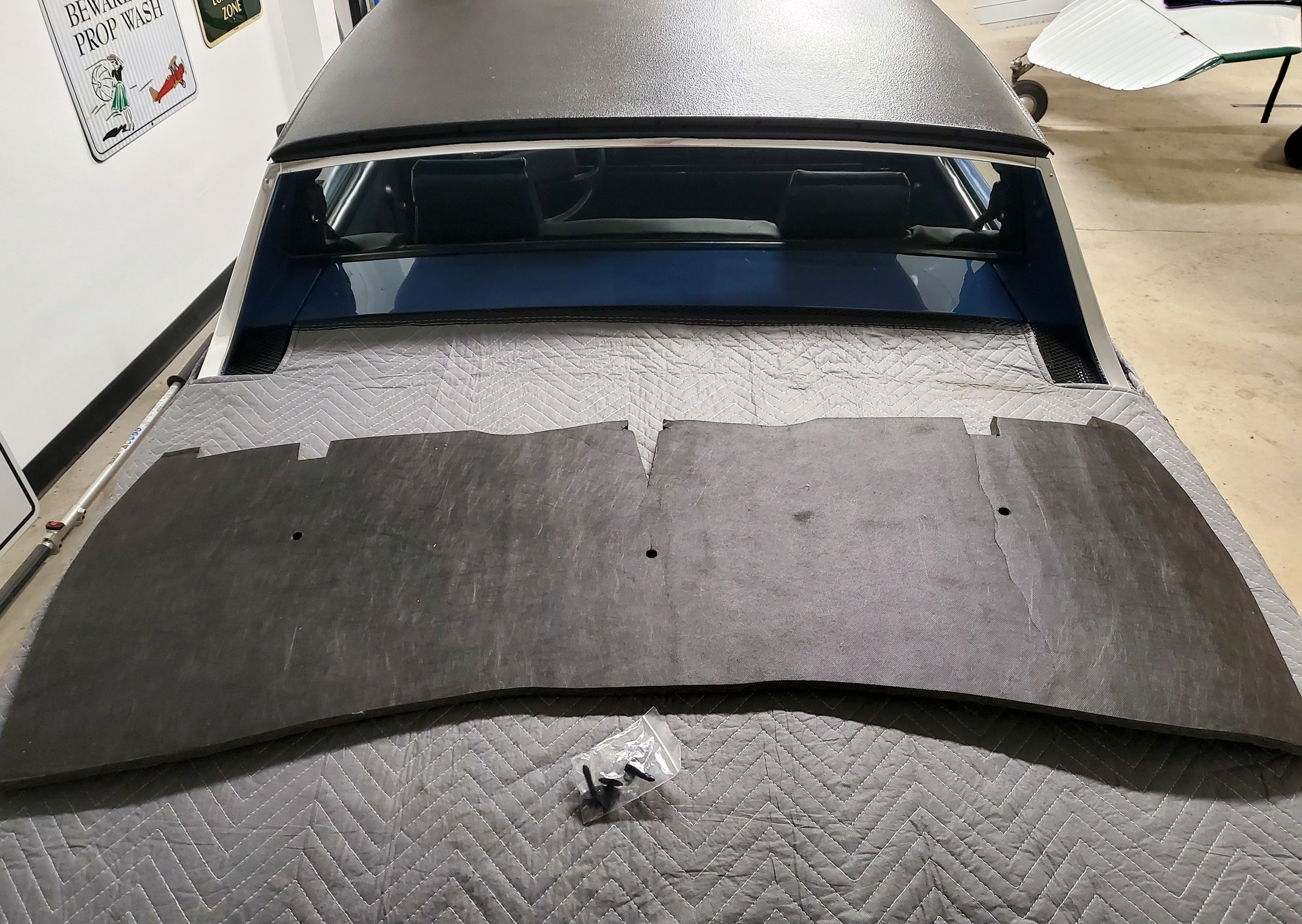

Root_Werks
post Oct 24 2022, 08:28 PM
Village Idiot
Posts: 9,031
Joined: 25-May 04
From: About 15NM from Canada
Member No.: 2,105
Arrived today, very nice quality. Came with 3 push pins.

Root_Werks   Arrived today, very nice quality. Came with 3 push...   Oct 24 2022, 08:28 PM
Root_Werks   Installation was easy, holes all in the correct sp...   Oct 24 2022, 08:31 PM
Cairo94507   Looks clean. :beer2:   Oct 25 2022, 06:25 AM
Root_Werks   Drove today, it certainly makes a difference and w...   Oct 25 2022, 03:12 PM
Cairo94507   Something else to think about. The problem is 6...   Oct 25 2022, 04:35 PM
Root_Werks   Something else to think about. The problem is 6...   Oct 25 2022, 04:43 PM
