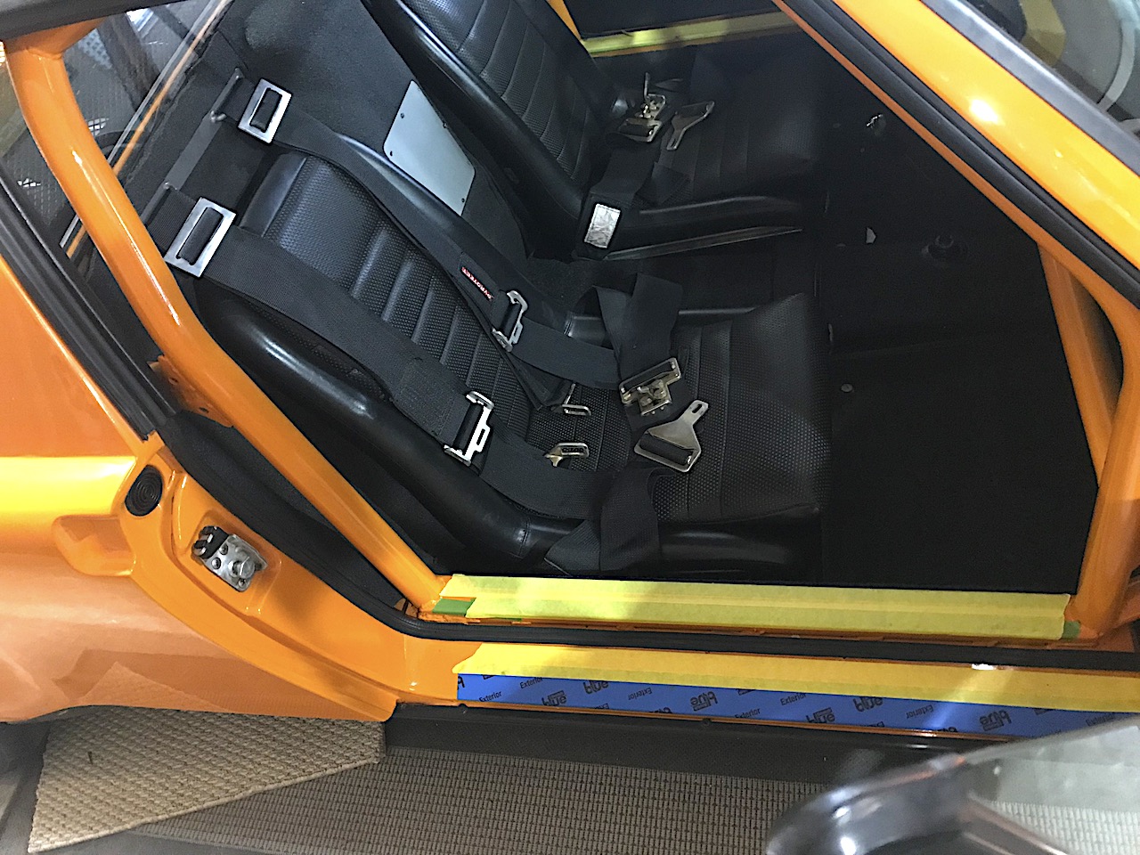

jmargush, I did the same thing last year, interior tar mat, then 1/2 foam and then thin layer of perlon carpet. I do not have anything on the engine compartment wall. It nocked noise down by more then half. I do have Ben's sport muffler so that end is pretty loud. Mark

Oct 19 2022, 07:04 PM
QUOTE(mlindner @ Sep 26 2022, 06:29 AM)
Click to view attachmentHi Mark,
Love your interior! Looks awesome. Just a little concerned not having head rests for safety. Take care!
