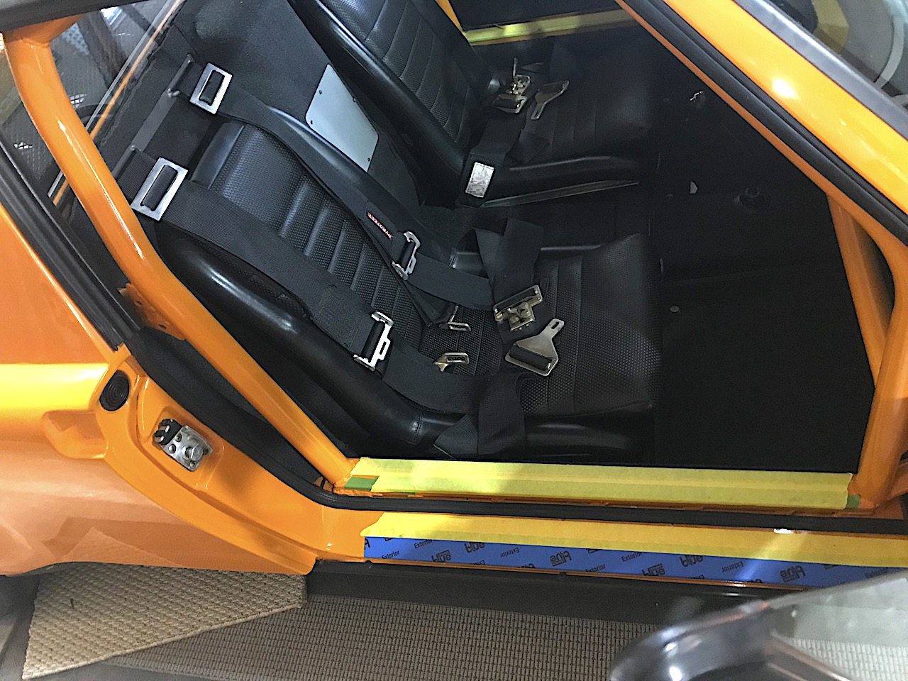

jmargush, I did the same thing last year, interior tar mat, then 1/2 foam and then thin layer of perlon carpet. I do not have anything on the engine compartment wall. It nocked noise down by more then half. I do have Ben's sport muffler so that end is pretty loud. MarkAttached Image
