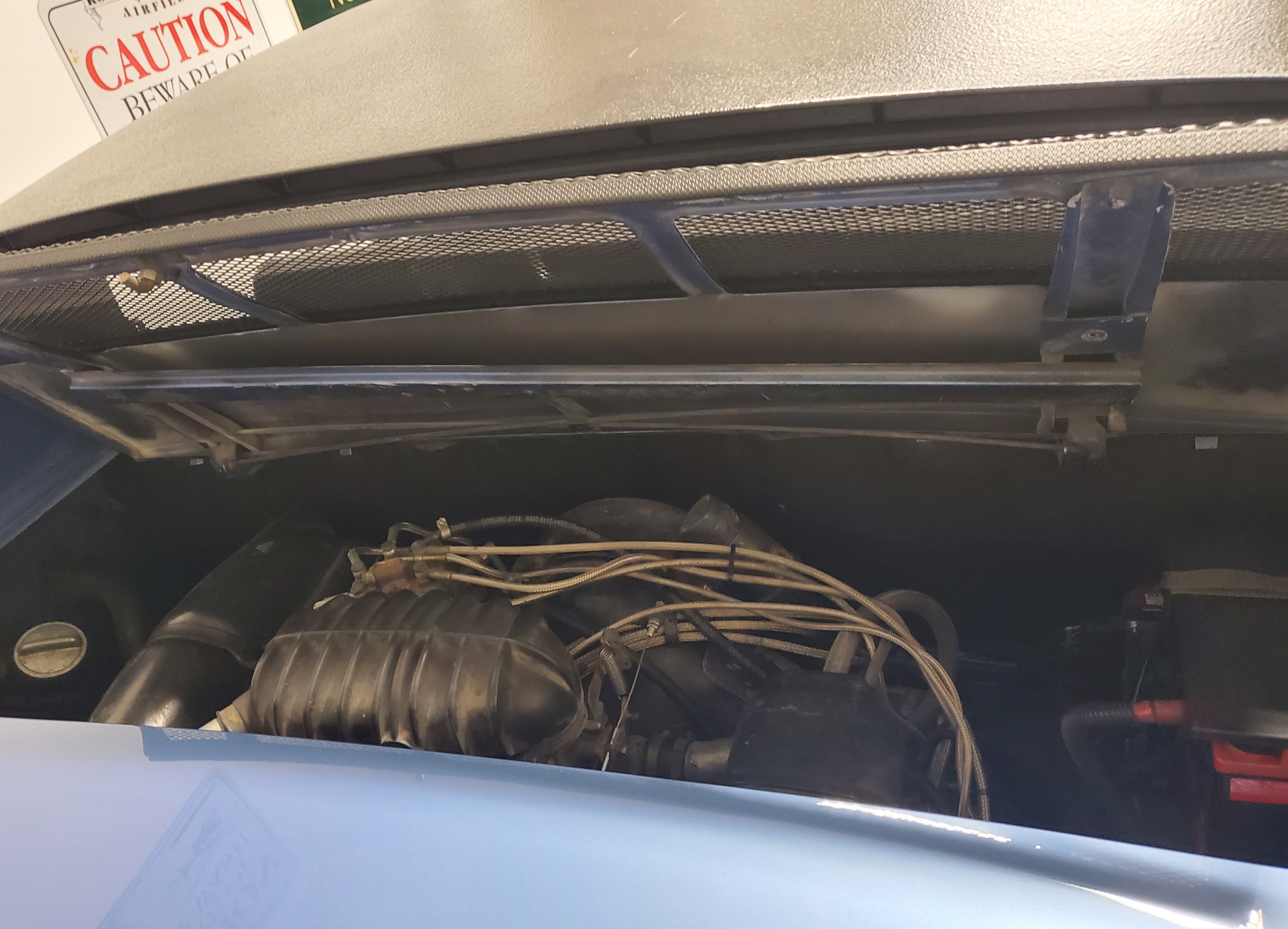

Village Idiot ![]() ![]() ![]() ![]() ![]() Group: Members Posts: 9,031 Joined: 25-May 04 From: About 15NM from Canada Member No.: 2,105 Region Association: Pacific Northwest
Installation was easy, holes all in the correct spot. Hopefully drive tomorrow and listen for reduced noise.
Attached thumbnail(s) |

Root_Werks Arrived today, very nice quality. Came with 3 push... Oct 24 2022, 08:28 PM
Cairo94507 Looks clean. :beer2: Oct 25 2022, 06:25 AM
Root_Werks Drove today, it certainly makes a difference and w... Oct 25 2022, 03:12 PM
