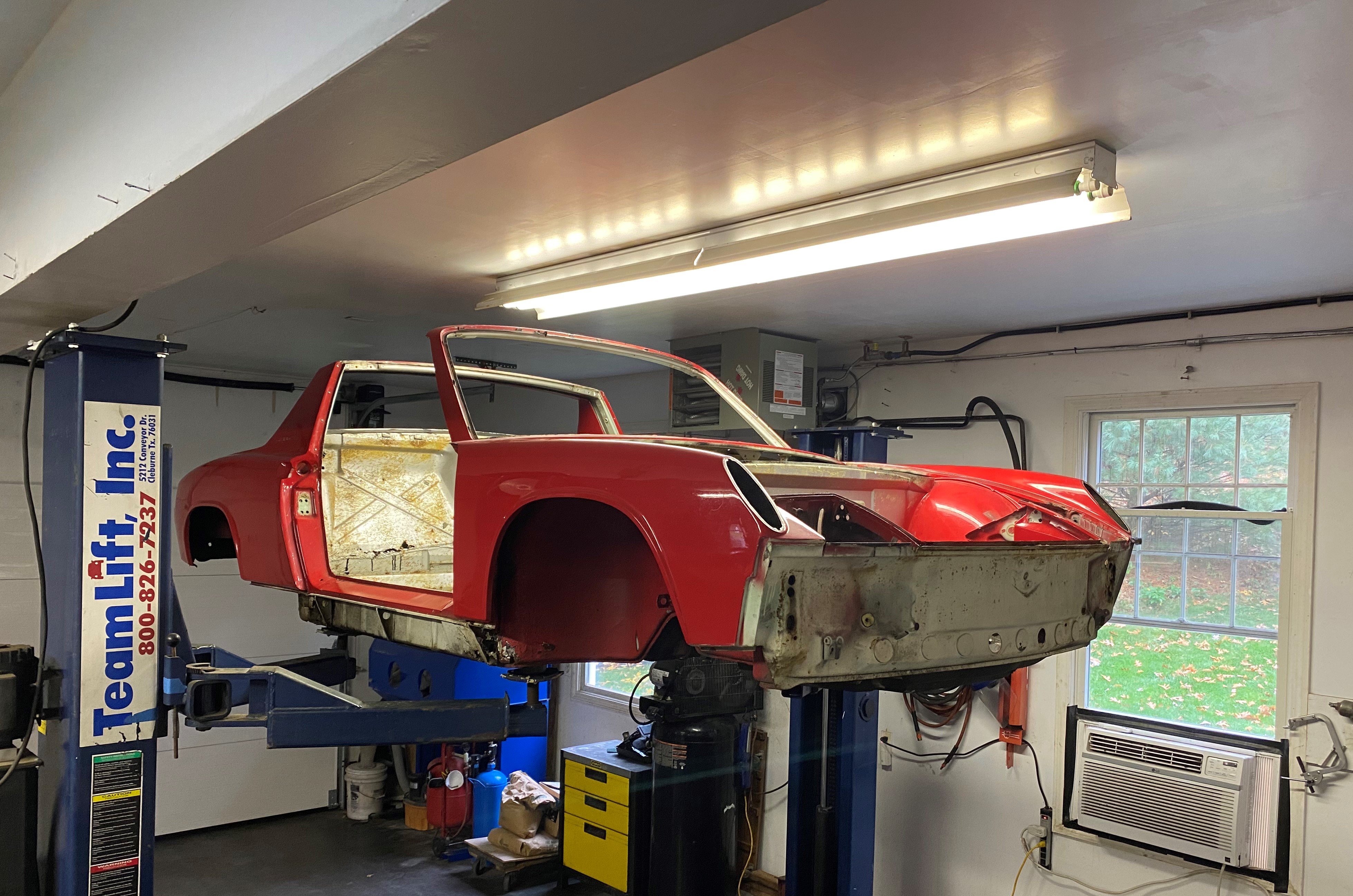

Time for an update on my GT project. After a long delay while waiting to clear garage space, I sold my 1970 911E restoration and moved the 914 from the basement to the garage and onto my lift. The car is now stripped to a bare shell. After consulting with Ken (body shop manager & co-owner) at Auto Associates, we have decided to send the shell out to be dipped, stripped and E-coated prior to starting the chassis restoration at Auto Associates.
Ken recommended a shop in Livonia, MI that does a multi step process consisting of:
1. Hot tank cleaning dip
2. Pressure wash to remove all dirt, gunk and paint
3. Acid dip to dissolve all rust
4. Neutralizing dip to stop the acid process
5. Epoxy primer for rust protection
The hot tank cleaning dip will dissolve anything that is not steel on the shell. This would include the longitudinal heater tubes. So we have decided to cut out the inner longs prior to the dipping and then replace the heater tubes and the longs as part of the chassis restoration. This should give us a chassis that is completely devoid of any rust and is also protected against any further rusting.
This will require an 11 hour one way drive from my home in CT to the shop in MI. I have searched and tried to locate a shop closer to my home that offers the cleaning, de-rusting and E-coating but have not located one. If anyone knows of a shop within a 6 hour radius of Hartford, CT that offers this process, I would be interested in checking them out.
