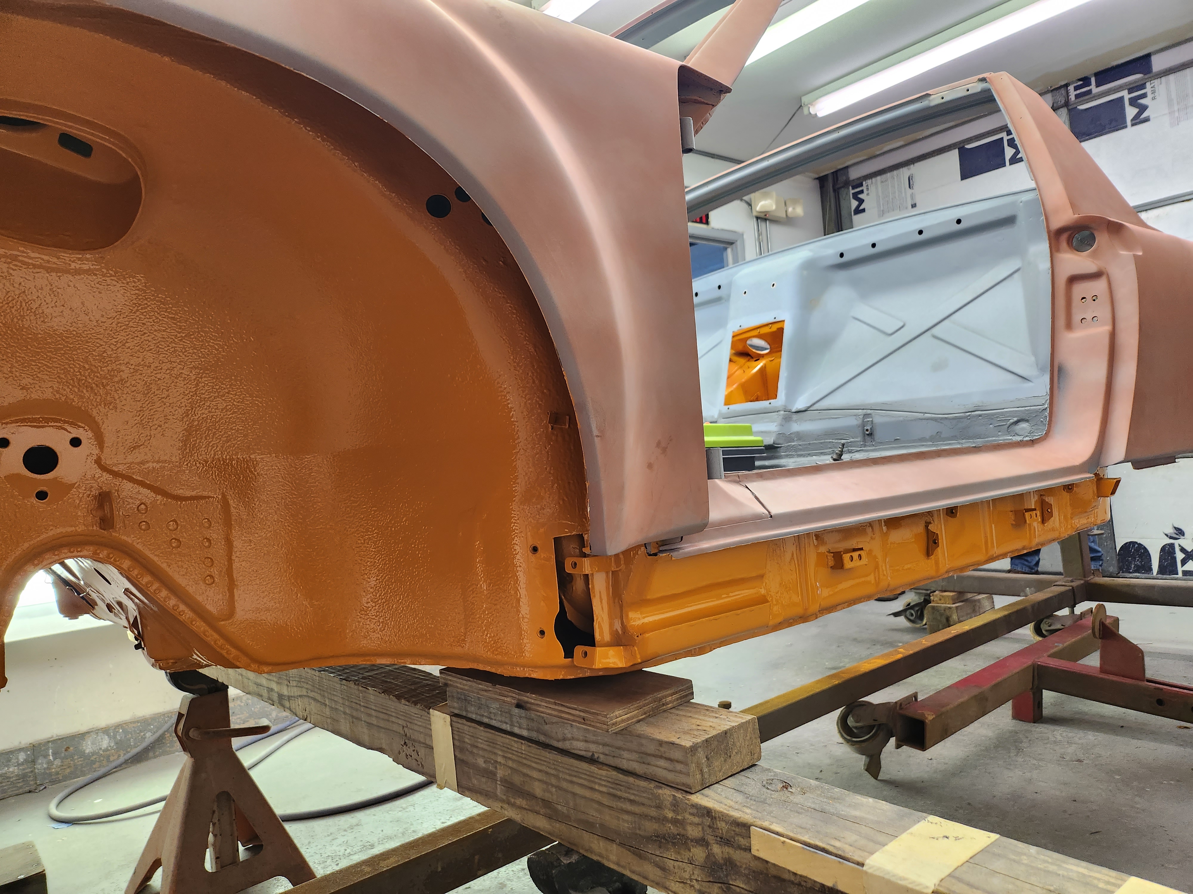

Seams sealed, underside schutzed and painted, hood pins fitted. They'll probably cut the fuel filler today. Very close to final paint, and finally back to Klub Sport for assembly.

Bullethead   Seams sealed, underside schutzed and painted, hood...   Nov 2 2022, 08:01 AM
