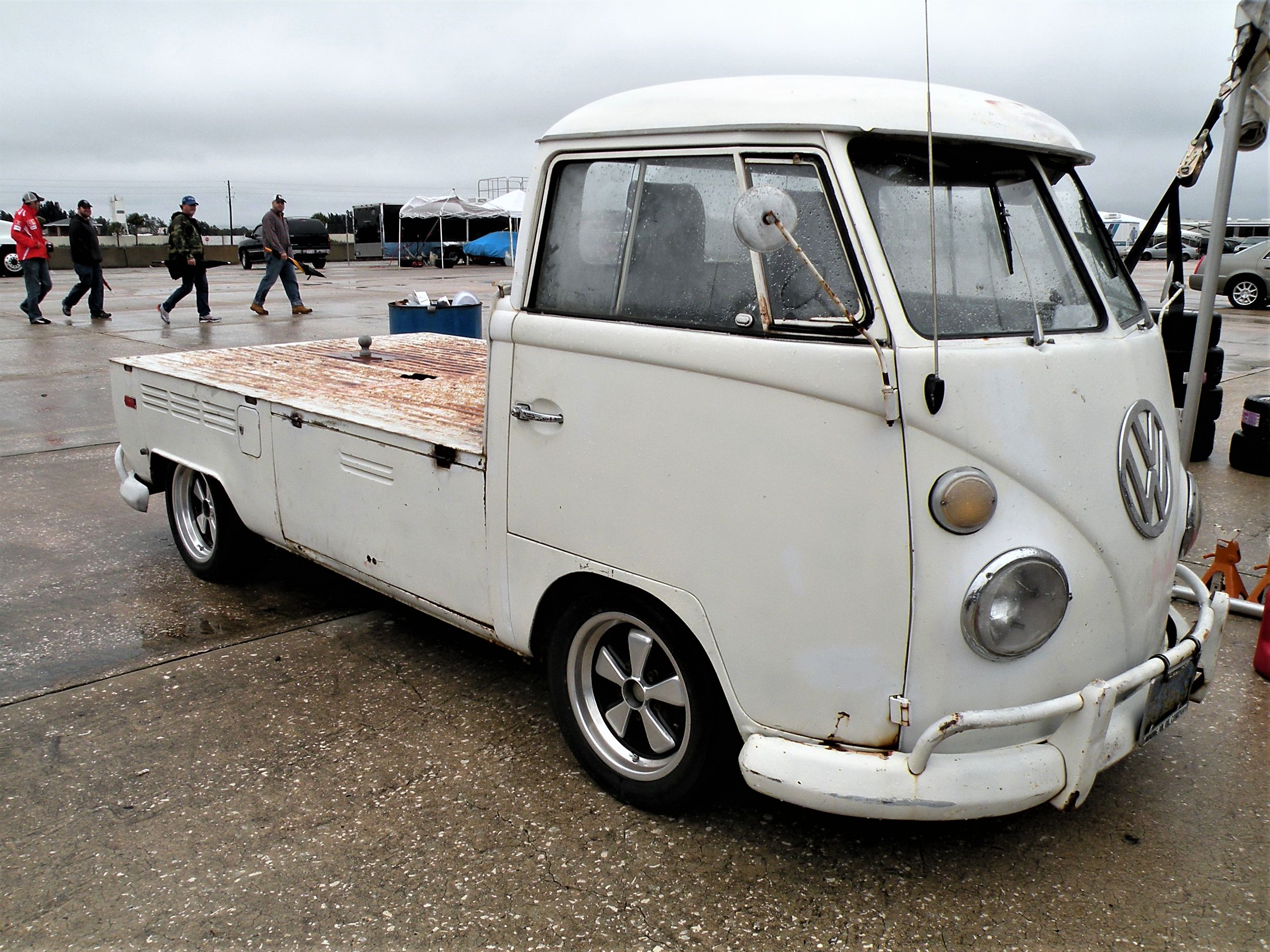

By all means, do it! Here's a single cab built by 901 Shop awhile back looking a bit scruffy, but it's really spiffy now. Note the fifth wheel hitch.
