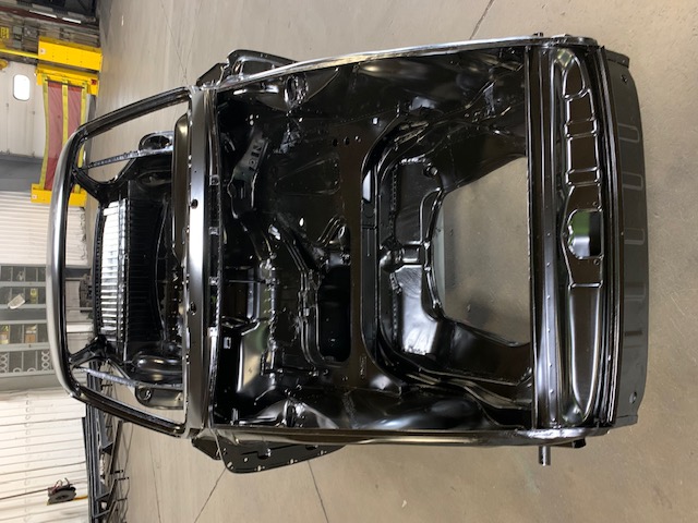

post Nov 4 2022, 11:29 AM
914-6 GT in waiting
Posts: 20,919
Joined: 19-September 09
Member No.: 10,825
Just got done e-coat

mepstein   Just got done e-coat   Nov 4 2022, 11:29 AM
TJB/914   Just got done e-coat M Outstanding :worship: T...   Nov 4 2022, 11:52 AM
rgalla9146   Just got done e-coat That's beautiful Mark...   Nov 4 2022, 04:26 PM
mepstein   Just got done e-coat That's beautiful Mar...   Nov 4 2022, 05:44 PM

dlee6204   Just got done e-coat Mind sharing the business ...   Nov 4 2022, 05:55 PM
mepstein   Just got done e-coat Mind sharing the business...   Nov 4 2022, 06:14 PM
mb911   [quote name='dlee6204' post='3039672' date='Nov 4...   Nov 5 2022, 08:25 AM
mepstein   [quote name='dlee6204' post='3039672' date='Nov ...   Nov 5 2022, 11:23 AM
