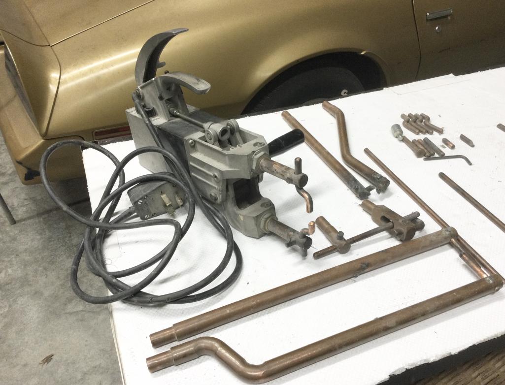

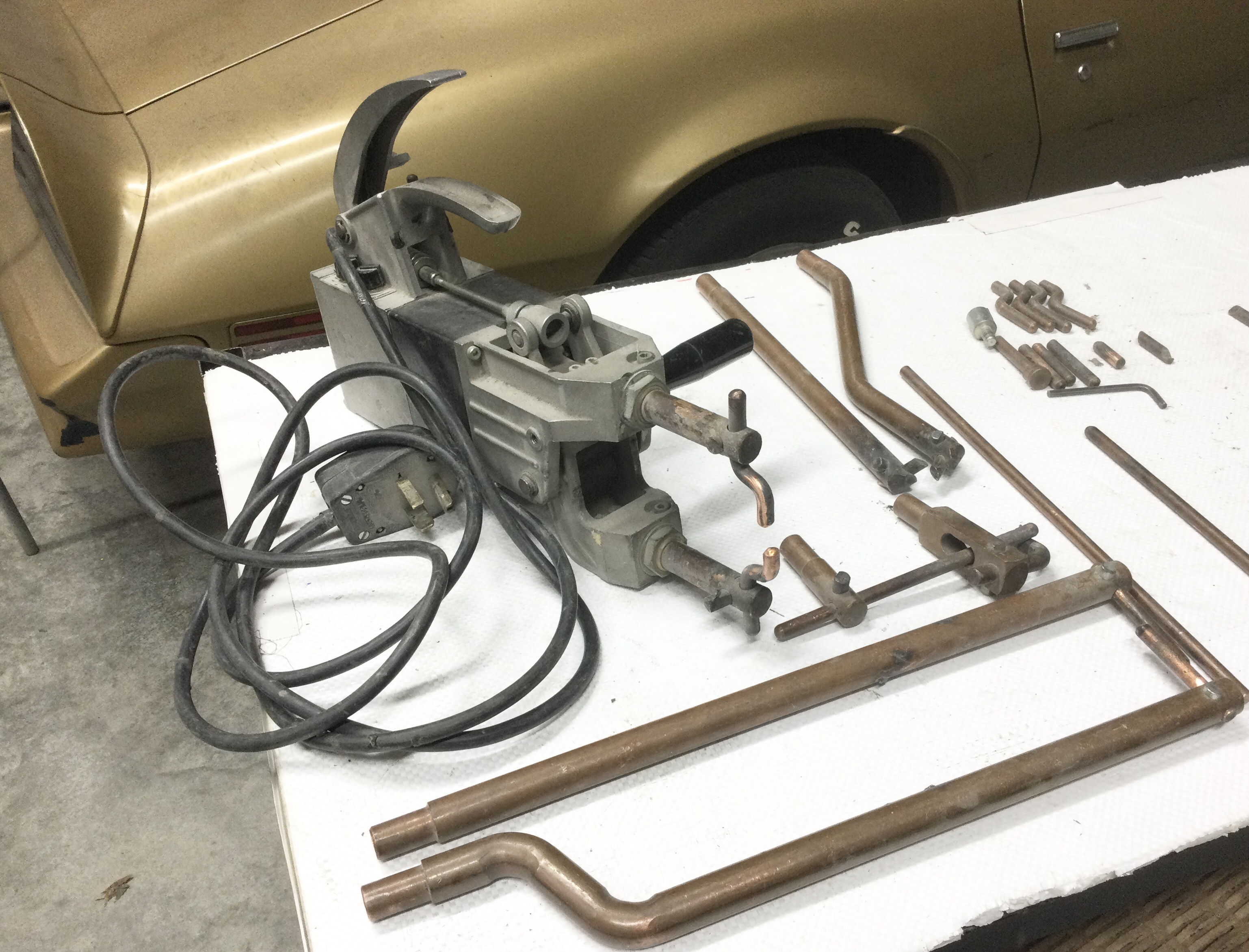

I bought a used spot welder on Facebook marketplace last week.
It has adjustable temp and time settings.
Paid $250 for it, but it feels like a much more heavy duty machine than the ones available at harbor freight.

Alain V.   I bought a used spot welder on Facebook marketplac...   Nov 7 2022, 06:52 PM
Alain V.   I did a little “testing” to figure out where t...   Nov 7 2022, 06:54 PM
Alain V.   I used it where the rear floor pan meets the lower...   Nov 7 2022, 06:56 PM
