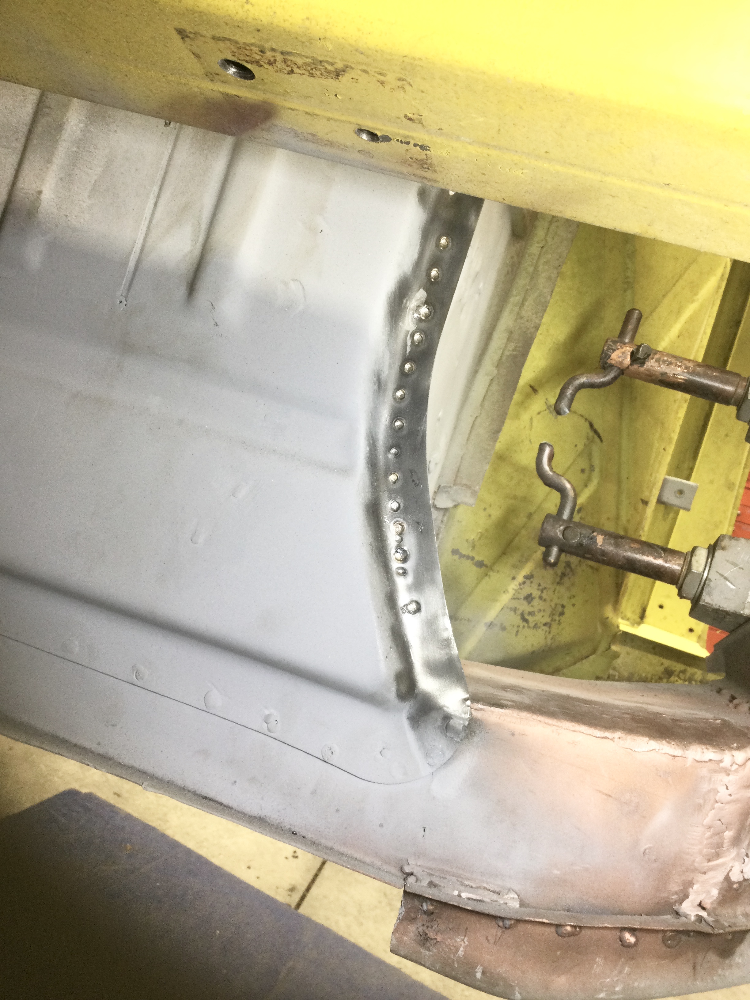

Alain V.   I bought a used spot welder on Facebook marketplac...   Nov 7 2022, 06:52 PM
Alain V.   I did a little “testing” to figure out where t...   Nov 7 2022, 06:54 PM
Alain V.   I used it where the rear floor pan meets the lower...   Nov 7 2022, 06:56 PM
