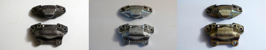

If you can't find any, I'd be happy to run them through my home-brew process. Been playing around with plating for a few months and still learning, so not perfect by any means, but hopefully good enough for use. Here's a brake caliper for reference. After cleaning, parts need a few strikes with zinc, then a dichromate dip for the gold color effect (and protection). Just let me know if you'd like me to give 'em a try.

More than happy to give'm a shot. Send whatever you'd like, as long as it's smaller that a brake caliper half, it'll fit in the cooler, er uh, chemical tank, that I rigged up for plating. I'm not gonna say what I used to plate the throttle cross member and rod since my wife may read these posts one day. (IMG:style_emoticons/default/biggrin.gif)
