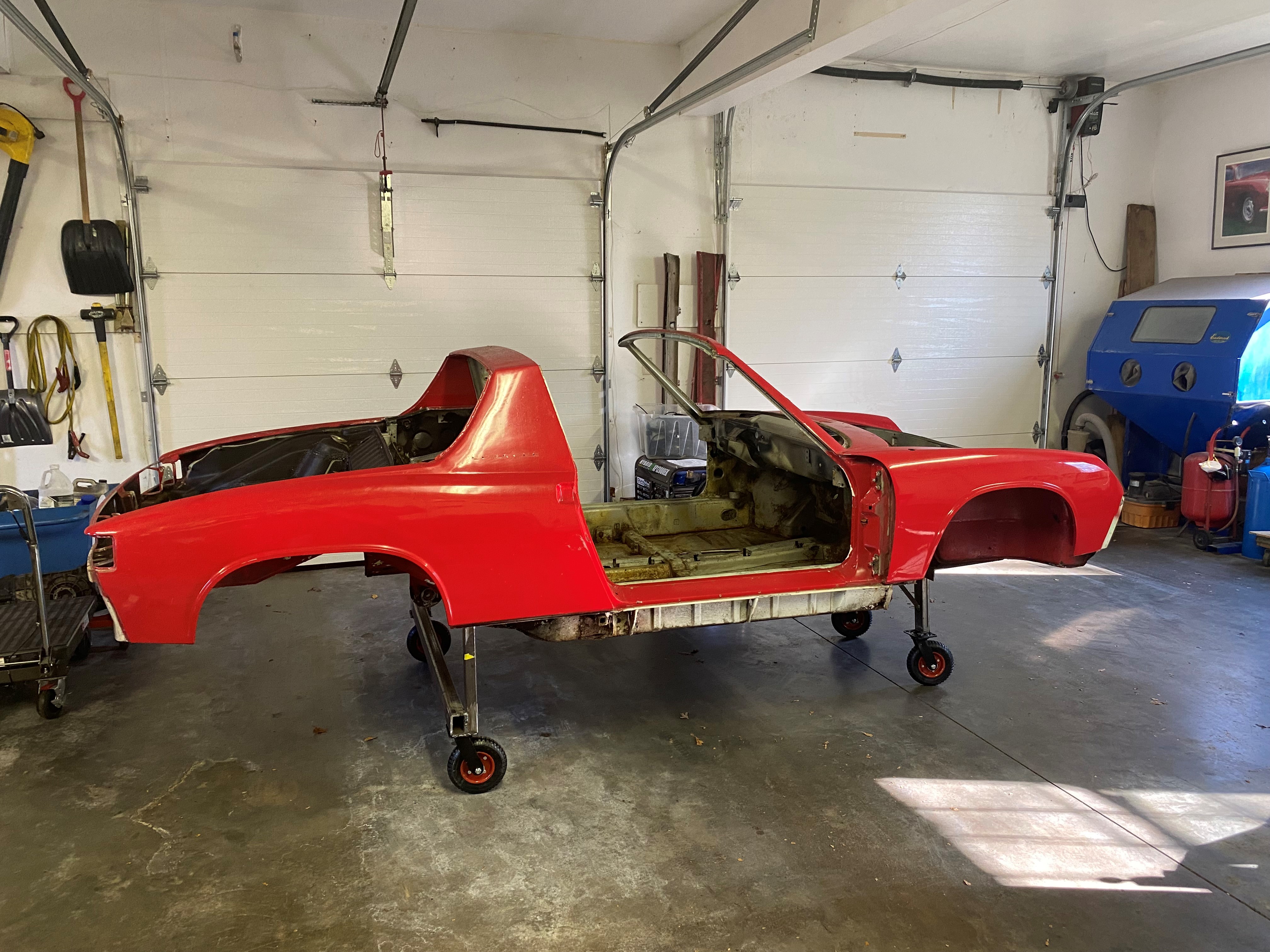

Tom1394racing
post Nov 29 2022, 09:01 AM
Posts: 525
Joined: 25-August 07
From: CT
Member No.: 8,039
The shell has been stripped and mounted on a custom cart for transport. The car will go next to Auto Associates where the inner longs will be removed along with the Al heater tubes. In addition, they will install longitudinal braces. Then the shell will be shipped to International Paint Stripping in Romulus, MI. They are the closest shop that does the Hot Tank/Acid/E-Coat Dipping all under one roof. Once the dipping has been completed the car will go back to Auto Associates for the chassis restoration and GT conversion.
