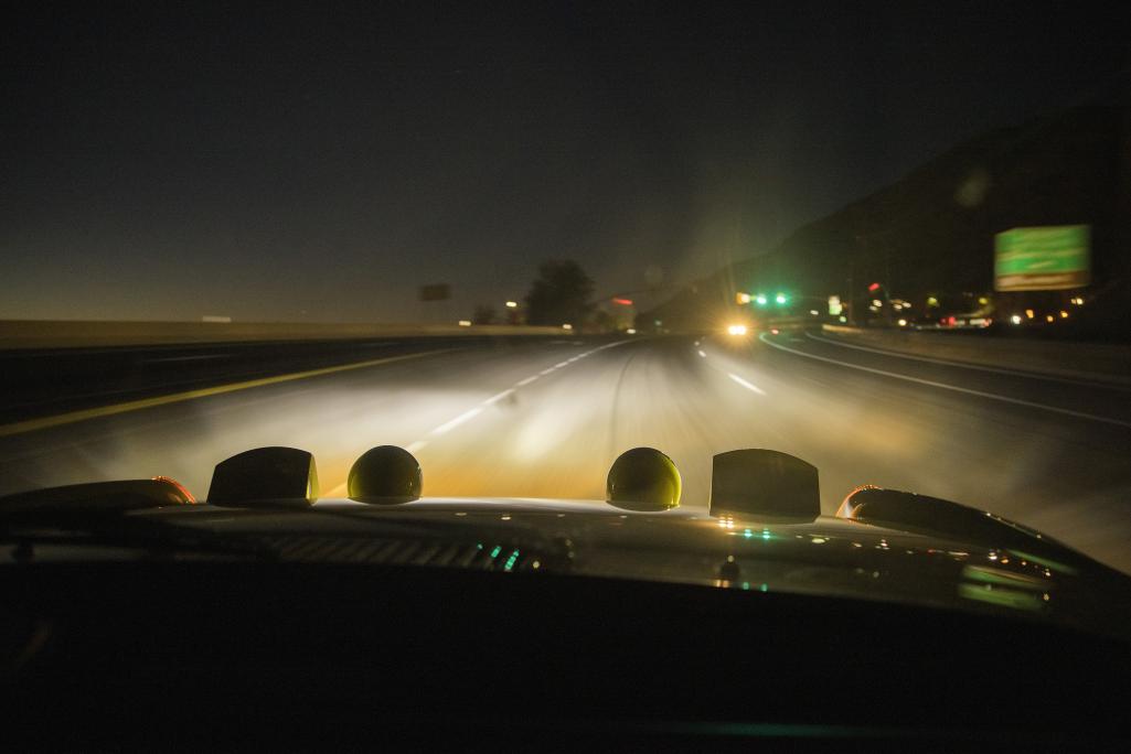

let there be light

burton73   let there be light! LED done by PMB PERFORMAN...   Nov 28 2022, 10:02 PM
porschetub   let there be light! LED done by PMB PERFORMA...   Nov 29 2022, 05:49 PM
burton73   let there be light Bob B   Nov 29 2022, 06:46 PM
