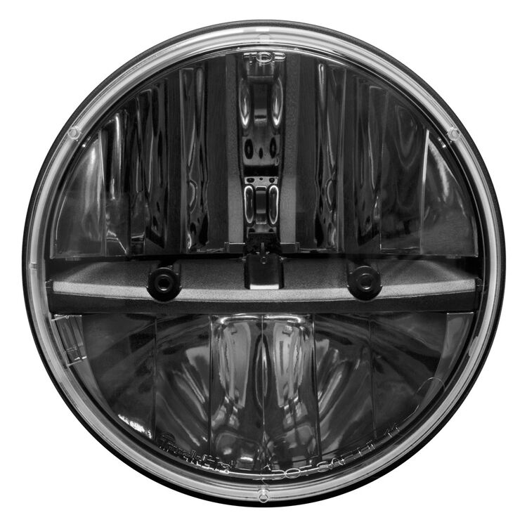

LED bulbs don't really work well, I'm going with a full unit. They look more like this...whatever the original version of this was, tons of knockoffs now:

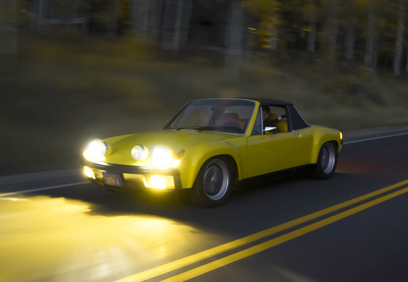

Driving through my rural winding roads, the Nighthawks are awesome. Lots of light, far down the road and to the side. I never get flashed by oncoming cars so I'm assuming the cutoff is good. The high beams are incredible.
We don't have streetlights so the light is especially noticeable. I'm also an early adopter and big fan of Spoke's lights. Easy to see, even in the day and no more melted rear housings.

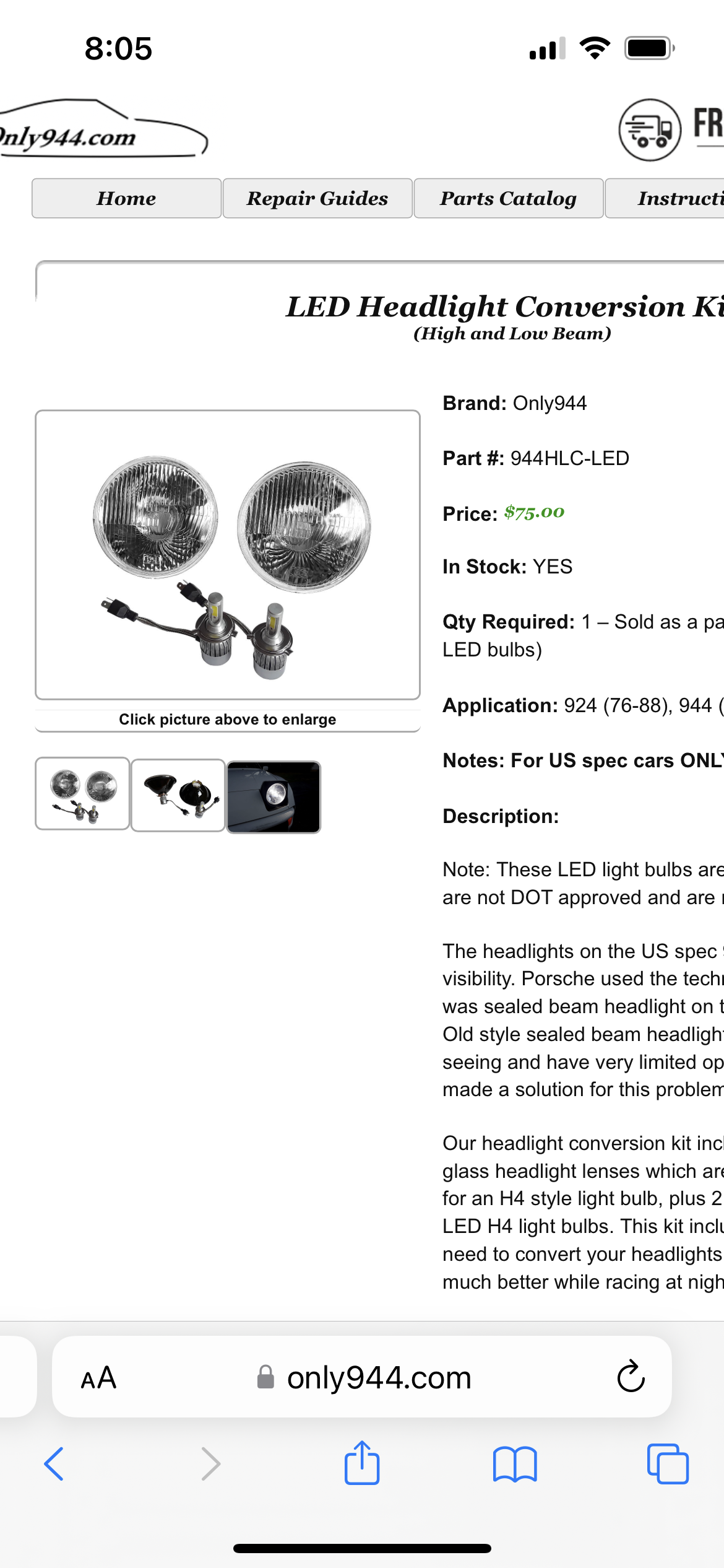

I’ve been looking at these. Currently $270 for a pair of bulbs and Hella lenses. Were these just plug and play?

I’ve been looking at these. Currently $270 for a pair of bulbs and Hella lenses. We’re these just plug and play?
Yes!

Count me in your camp.
One LED vendor sent me the right bulbs in the wrong housings, then told me to just keep the bulbs and put them in my existing H4s—admitting there's nothing different or special about its "premium" H4 housings for its LED bulbs. Its website sure "led" (sorry… ) me to believe the H4 housings it sold were somehow matched to the LED bulbs, and also left me thinking the company developed its own bulbs—which is funny, because what looked like the very same bulbs less a stenciled logo were available on Amazon for $29~/pair iirc.
My hangup is wanting modern LED performance and efficiency (less heat, less draw, less stress) with vintage looks…even when the lights are up. None I've seen did that, until I spotted these…but they aren't cheap.
My only question for those is how far out does the face of the light protrude? They look similar in protrusion to the GE Nighthawks I had. Ultimately, someone has to buy a set and try the fitment. I like the look of the whole unit aside from that.
bbrock
Oct 22 2022, 06:17 PM
QUOTE(horizontally-opposed @ Oct 22 2022, 04:29 PM)
That actually isn't a bad price for LED assemblies. Not much more than I paid for my Truck-lites a couple years ago and less than I would have to pay today.
@Cairo94507 I always thought the Truck-Lite and GE Nighthawks were the same lights but maybe not. My Truck-Lites were plug and play with no fitment issues at all.

QUOTE(iankarr @ Jan 11 2022, 06:42 PM)
I put LED's in both of my 914s and the difference is amazing. I made a video of the install...and there's a scene showing the before/after...
Ian, you mentioned a link to your video about installing the resistors for the fog lights to work. Please post it, I don't see it.
