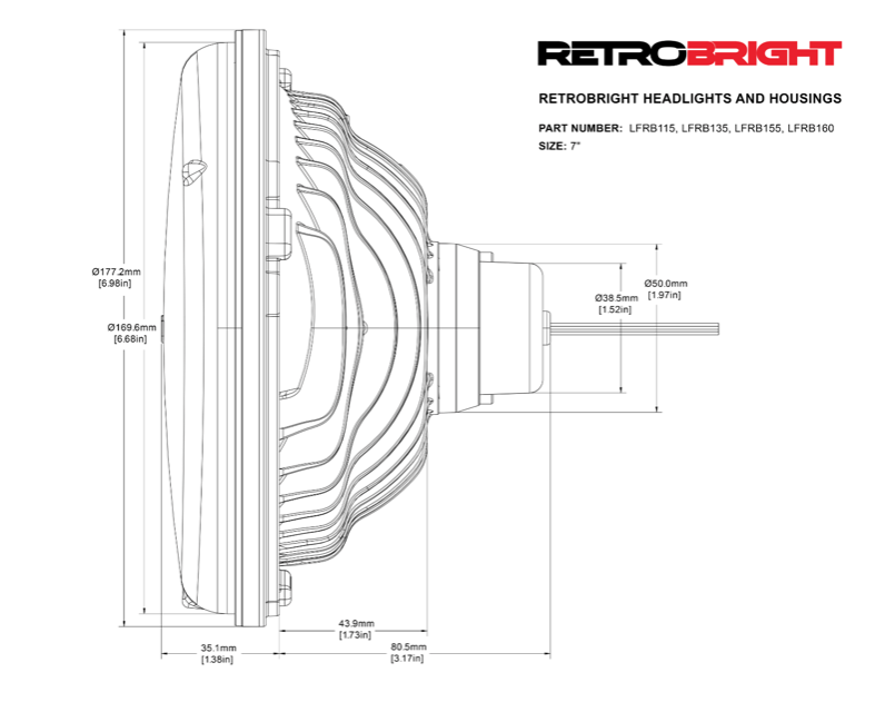

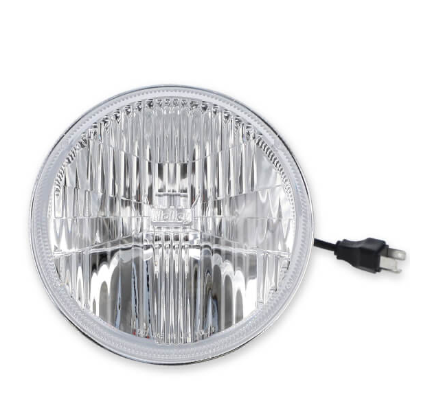

Nice find! The Holley lights look good. Only question might be mounting depth…
https://www.holley.com/products/exterior/li...s/parts/LFRB135
Attached Image Attached Image Attached Image Attached Image Attached Image Attached Image

I agree. Nathan seems to have found a great solution. But I think someone needs to bite the bullet and buy a set to see how they fit.
One of the issues with the GE Nighthawks in my car was the headlight protruded from the pocket about 1/4" more than stock which meant we had to adjust the "eye brows" so the light did not hit them when opening and closing. Left a bit more of a gap than a stock headlight would require. Overall, not a big deal, but just so you know.
