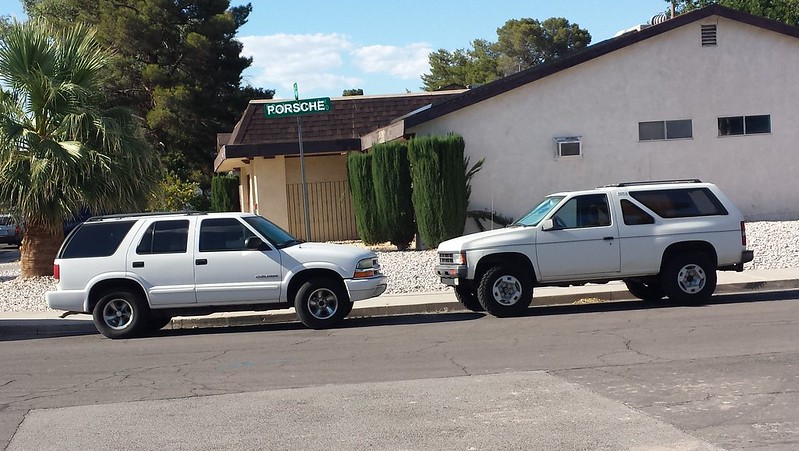

After RRC I wasn't in a hurry anymore... and I discovered Link now makes a plug-in 350z ecu... so I started rethinking the plan. (IMG:style_emoticons/default/idea.gif) I have a vq35de harness hidden somewhere. Nissan makes a floor mounted e-gas pedal. The 3.0L ecu will run the 3.5L but things will be a bit off so a new ecu was on the list anyways.
Plan the work. Work the plan. Change the plan. Spend more money. (IMG:style_emoticons/default/dry.gif)
But luckily for my wallet I was motivated to work on something else. Plus it gets cold in my north facing garage.
The infamous 1988 Nissan Partsfinder is pretty much worn out @233k. It's fine for local needs but sucks for touring and can barely get it's own butt up the Baker grade - forget towing a 914. I was looking into a newer Pathfinder (one with the vq35de (IMG:style_emoticons/default/biggrin.gif) ) when circumstances offered a likely better option.
The next door neighbor's 2004 Chevy Blazer broke again and he was ready to move on. He took good care of it and I did most of the previous fixes, so I couldn't say no.
BUT, what I thought was a bad spark plug wire and broken motor mount was actually a leaking injector and hydrolock damage (IMG:style_emoticons/default/sad.gif) So it sat for a while, because, frankly, Partsfinders don't break. (IMG:style_emoticons/default/aktion035.gif) Eventually I scored a 61k engine & trans from a wrecked 2001 S10. Last winter I finally committed to fixing it. I got it put together and running again by this summer but there were some other issues.
After the 16 hours of driving for RRC I was motivated to finish the Blazer. Still a few little things but at this point it's practically restored reconditioned. Will I unintentionally also drive this Partzfinder for 15 years? (IMG:style_emoticons/default/confused24.gif)
