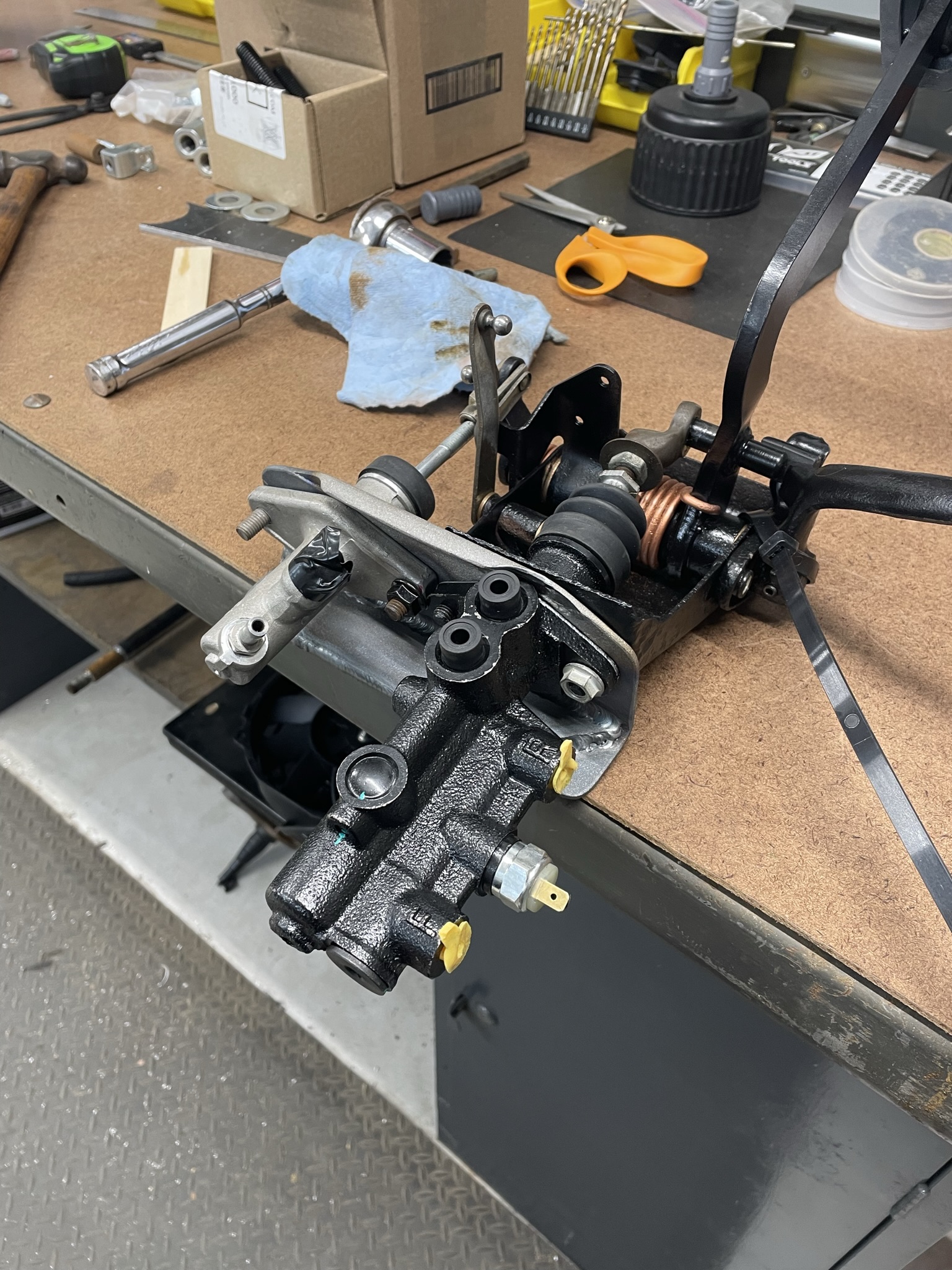

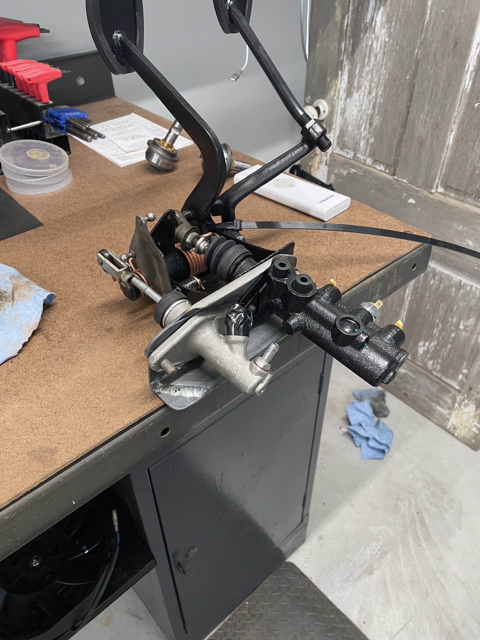

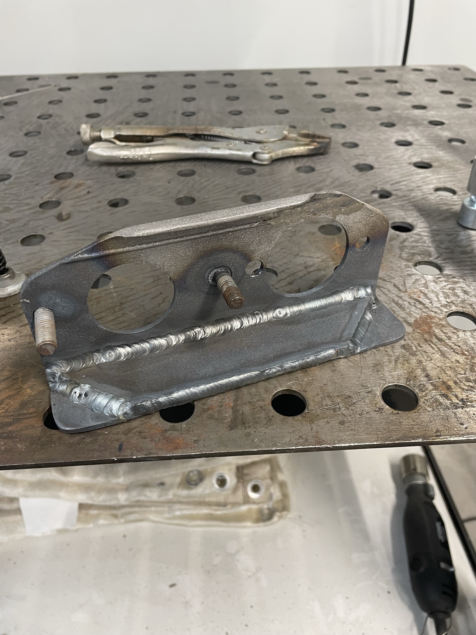

A small diversion project to allow me to work in the heated portion of my shop on a cold damp day. Fab’d up the bracket for the clutch master cylinder.
