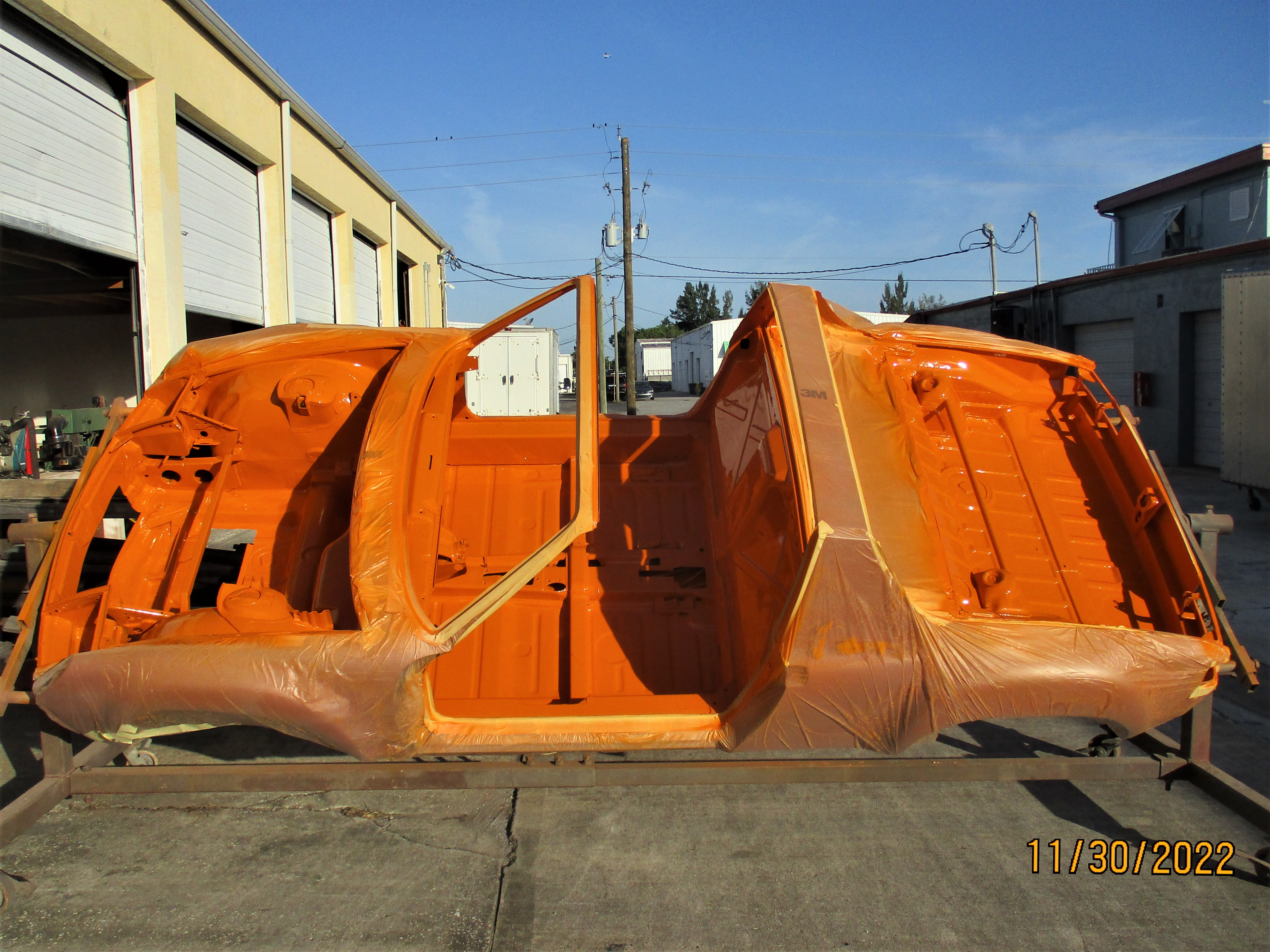

More paint done... lots of details to address. Underside, cockpit, engine compartment and trunks are all single stage. It's hard to get even color when cutting and buffing final, so the exterior will be two stage. Very close to reassembly time.
