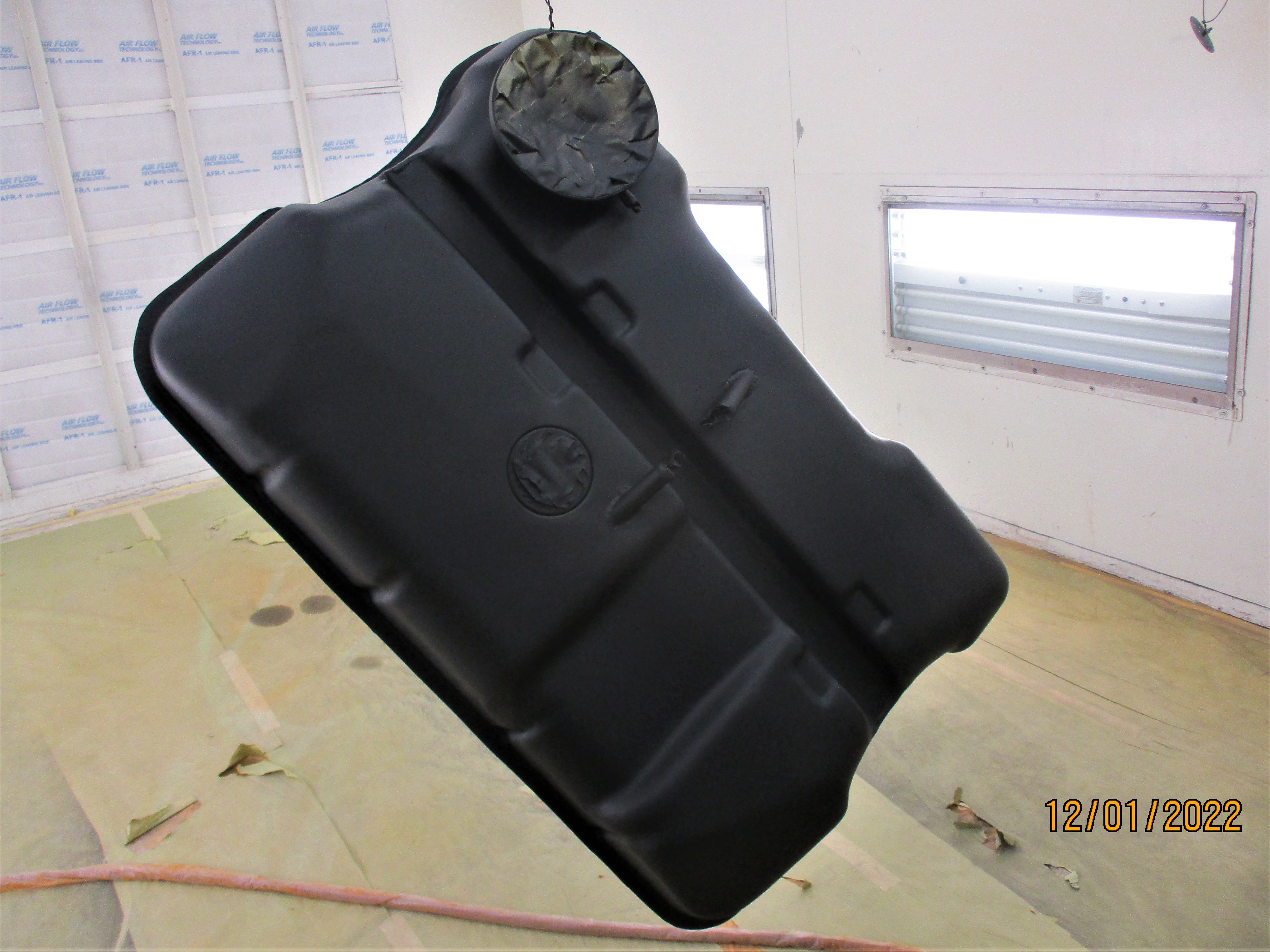

Bullethead   More paint done... lots of details to address. Und...   Dec 5 2022, 02:59 PM
Bullethead   RE: 1970 914/6 GT Replica Build   Dec 5 2022, 03:00 PM
Bullethead   The old foam in the tank was dust, so it was boile...   Dec 5 2022, 03:00 PM
