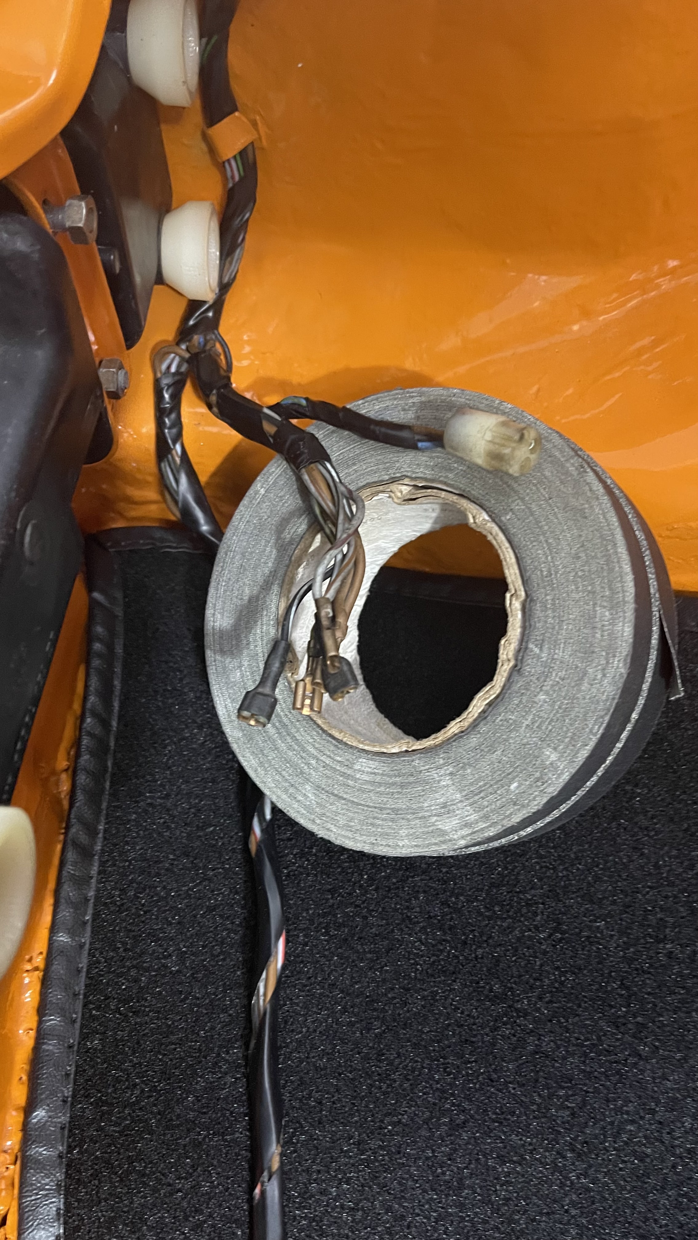

> Can someone identify this, a plug from the interior wiring harness
Type 47
post Dec 5 2022, 08:53 PM
Posts: 792
Joined: 1-June 10
From: St. Louis, MO
Member No.: 11,790
Not sure I remember this in the disassembly or with any of my other 914's.
JeffBowlsby
post Dec 6 2022, 12:37 PM
Posts: 9,128
Joined: 7-January 03
From: San Ramon CA
Member No.: 104
So its a known 49-state 75 2.0L wiht no EGR or CAT, and it has the wiring in place for the CA-model EGR system.
Can you tell me if it also has the wiring for the CAT sensor/relay in the rear trunk by the drivers side rear tailight housing? It may just be a few 1/4" female wire terminals taped to the harness and not used.
Really appreciate your confirmation.
@Type 47
Type 47
post Dec 6 2022, 03:01 PM
Posts: 792
Joined: 1-June 10
From: St. Louis, MO
Member No.: 11,790
QUOTE(JeffBowlsby @ Dec 6 2022, 10:37 AM) *
@Type 47
Yes confirmed. Original owner purchased car new from a Porsche dealer in St. Louis.
There is similar wiring in the rear trunk on the drivers side.
Note: electrical tape is still on wiring harness from reinstallation, cloth tape has to be wrapped before trunk gets wrapped up.
Type 47   Can someone identify this   Dec 5 2022, 08:53 PM
JeffBowlsby   What year is your car?   Dec 5 2022, 09:29 PM
JeffBowlsby   What year is your car? Again I ask? It connect...   Dec 5 2022, 11:22 PM
Type 47   What year is your car? Again I ask? It connec...   Dec 6 2022, 11:03 AM
windforfun   Not sure I remember this in the disassembly or wi...   Dec 5 2022, 09:30 PM
Type 47   an early 75'   Dec 5 2022, 09:42 PM
ejm   That is for the EGR counter box that would be in t...   Dec 5 2022, 09:50 PM
windforfun   That is for the EGR counter box that would be in ...   Dec 5 2022, 09:55 PM
Type 47   That is for the EGR counter box that would be in ...   Dec 5 2022, 10:13 PM
Dave_Darling   What is an EGR counter box? It is a box that si...   Dec 6 2022, 04:03 AM
Gatornapper   Interesting. Guess my '76 CA car has this tho...   Dec 6 2022, 08:12 AM
Chris H.   Interesting. Guess my '76 CA car has this th...   Dec 6 2022, 08:18 AM
Gatornapper   No can do. Car is 40 min. away at restoration pai...   Dec 6 2022, 02:20 PM
930cabman   My '75 CA car has this connection and a rebate...   Dec 6 2022, 08:18 AM
JeffBowlsby   So its a known 49-state 75 2.0L wiht no EGR or CAT...   Dec 6 2022, 12:37 PM
930cabman   So its a known 49-state 75 2.0L wiht no EGR or CA...   Dec 6 2022, 03:00 PM
Type 47   So its a known 49-state 75 2.0L wiht no EGR or CA...   Dec 6 2022, 03:01 PM
JeffBowlsby   That solves a mystery, thank you. I have only eve...   Dec 6 2022, 03:32 PM
aturboman   I recently revived a 75 CA car and it had a relay ...   Dec 6 2022, 03:51 PM
JeffBowlsby   That appears to be the case.   Dec 6 2022, 04:01 PM
DRPHIL914   That solves a mystery, thank you. I have only ev...   Dec 7 2022, 01:27 PM
JeffBowlsby   :thumbsup: Thanks DrPhil   Dec 7 2022, 02:44 PM
