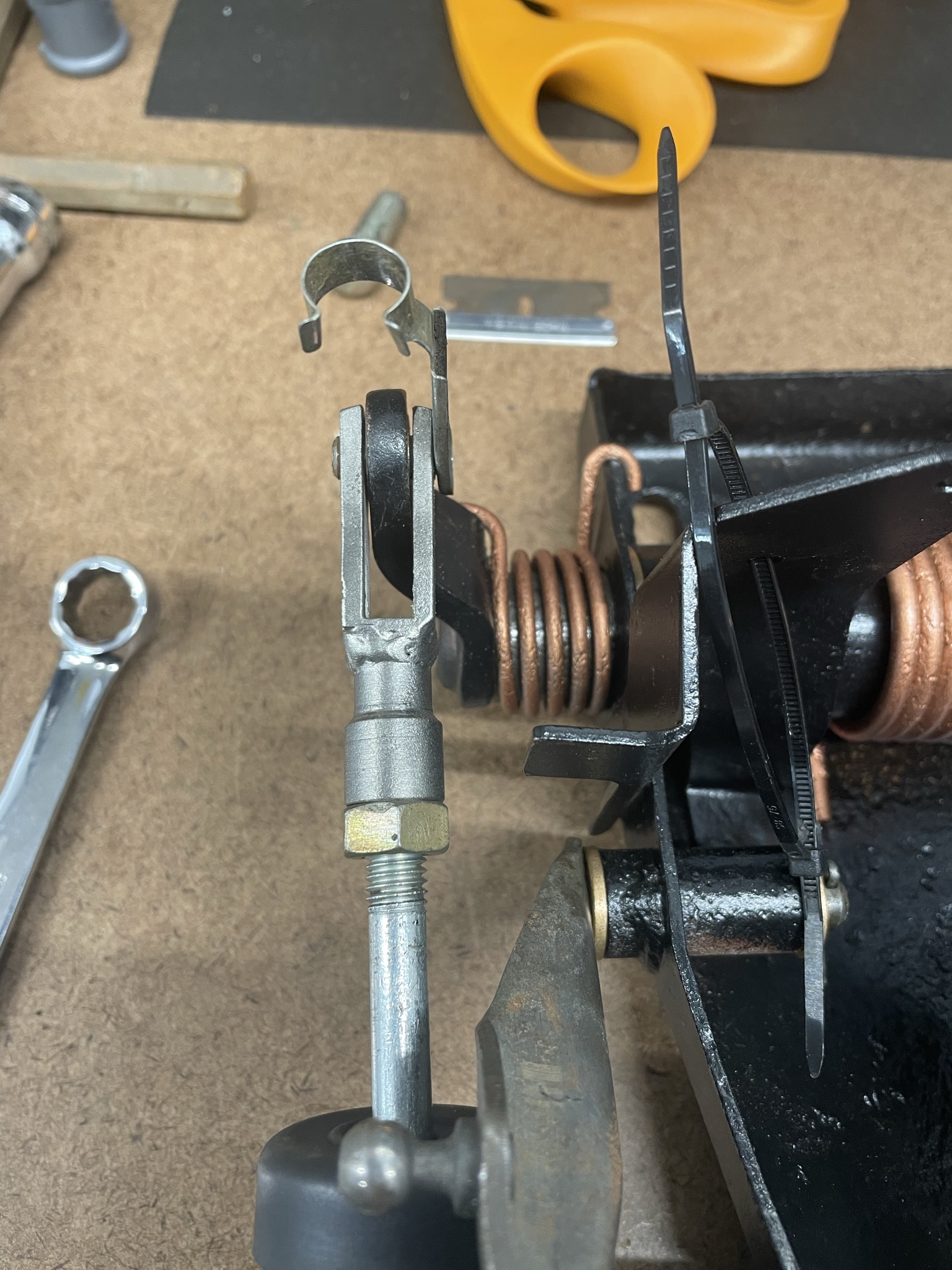

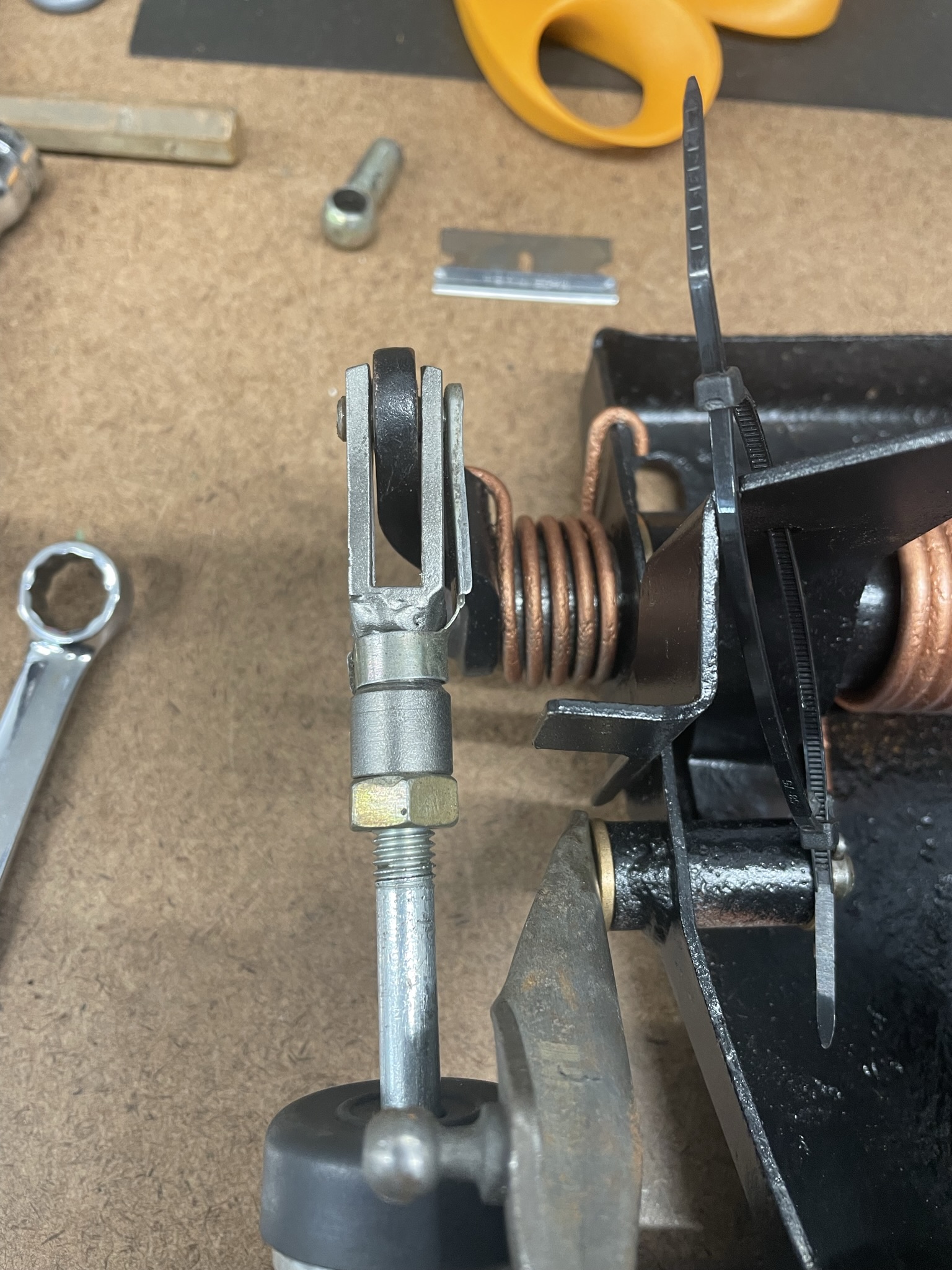

Machined a conversion part for the clutch clevis. Just turned a piece of 1/2” steel to make the clevis end the diameter of the stock clevis threaded area so the pin will still clip on, then a radius to the larger diameter to provide enough beef for the 8mm thread of the Honda master cylinder. Welded the new part to the stock clevis and all lines up and functions well.
