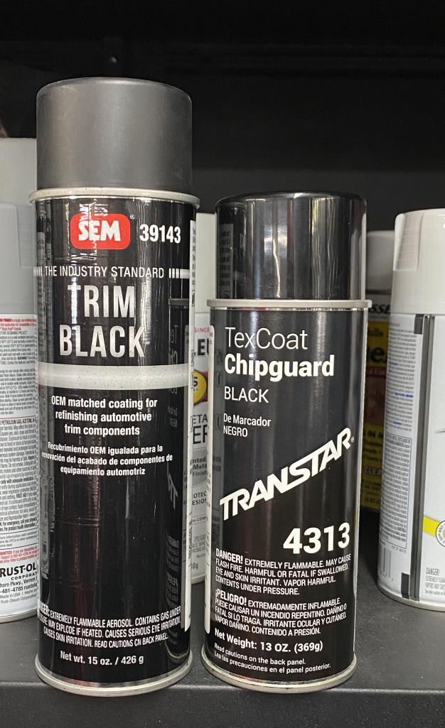

All great info plus…
If needing retexture, suggest this product. Can knock it down with sanding to get just the right texture- likely two cans needed for the whole top if starting from a smoothly sanded state.
SEM black pictured overall a good sheen and black tone match for our 914s.
Highly recommend compatible SEM primers if not going with a 2k primer.
