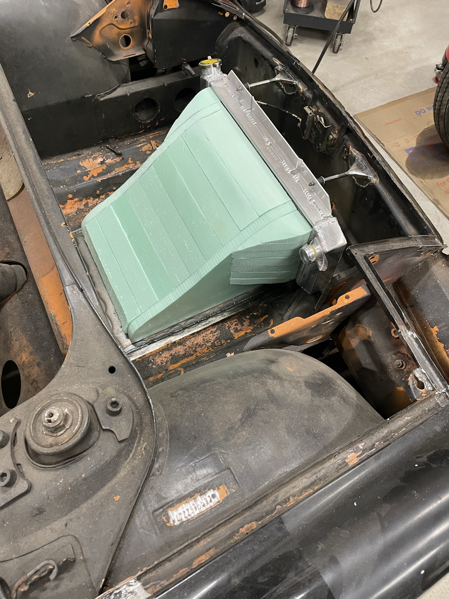

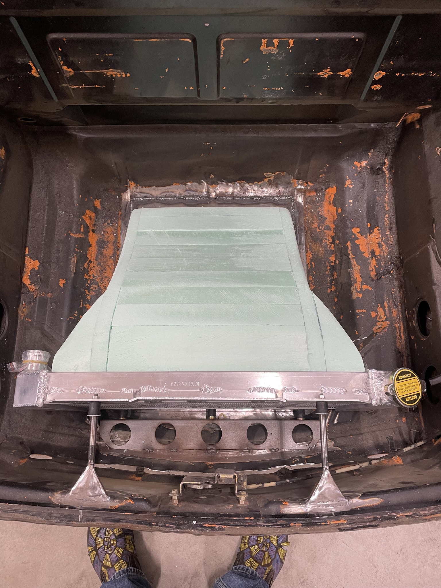

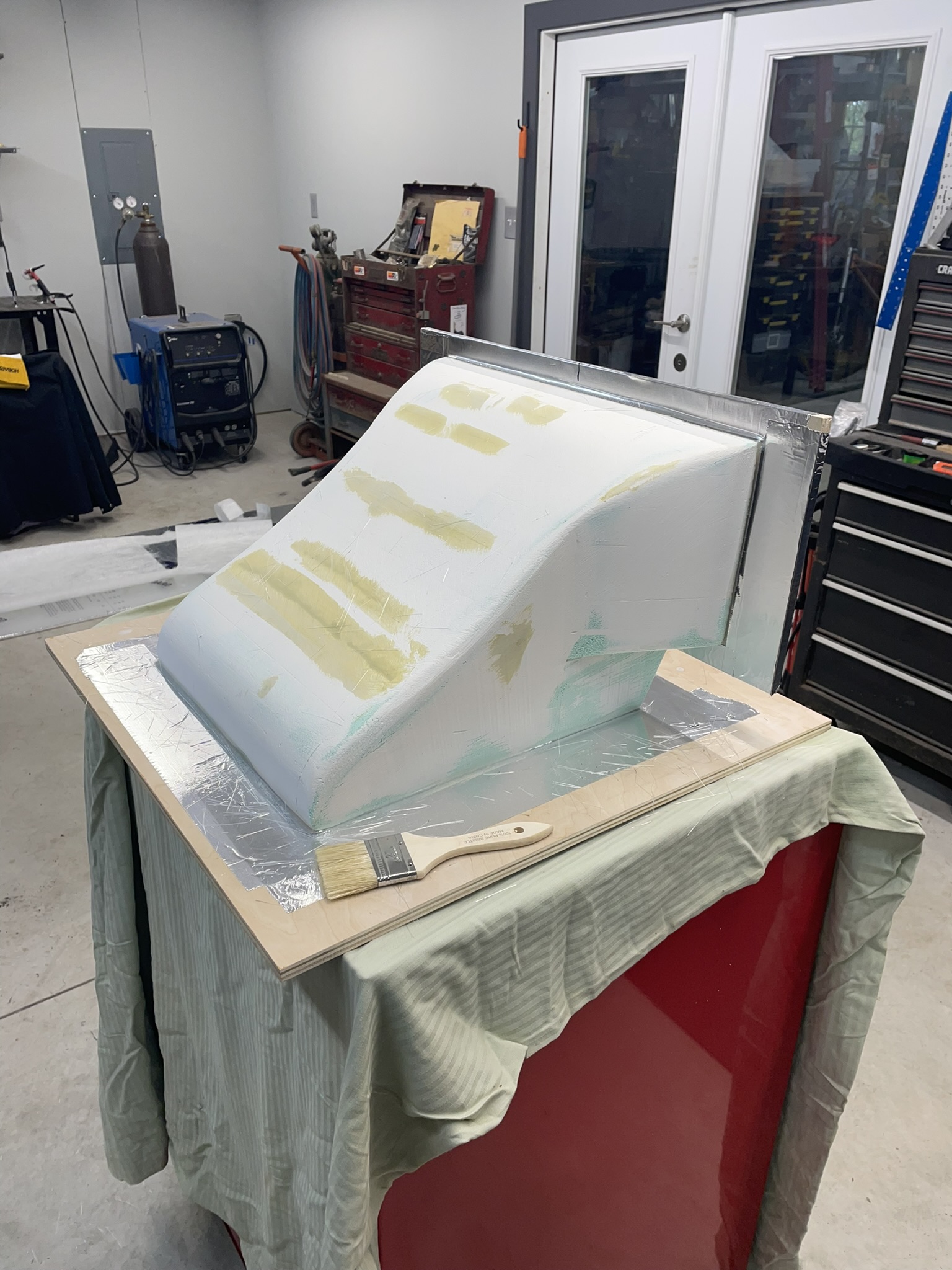

With radiator mount completed, it was on to the fabrication of the exit plenum. A little foam and filler to create a “buck”, then on to a little carbon/Kevlar layup. It came out well and I’m now laying up an entrance plenum to go between radiator and inlet opening. The plenums will have a thick rubber seal to isolate the plenum from the radiator and keep a tight seal.
