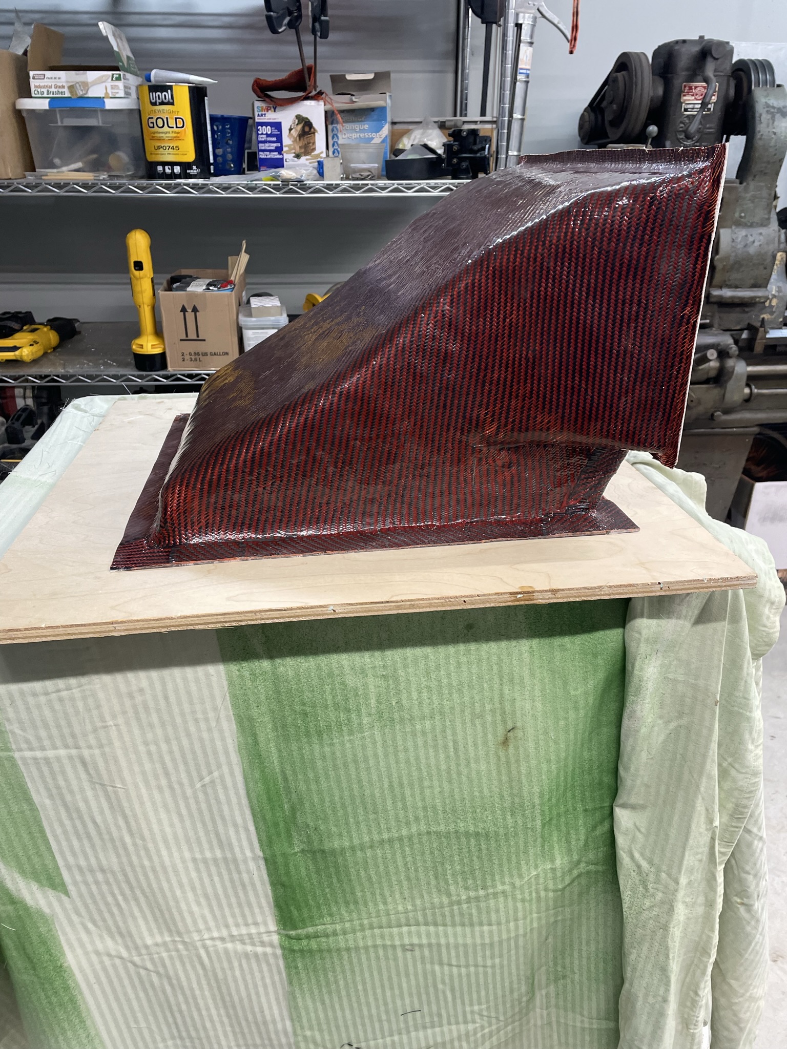

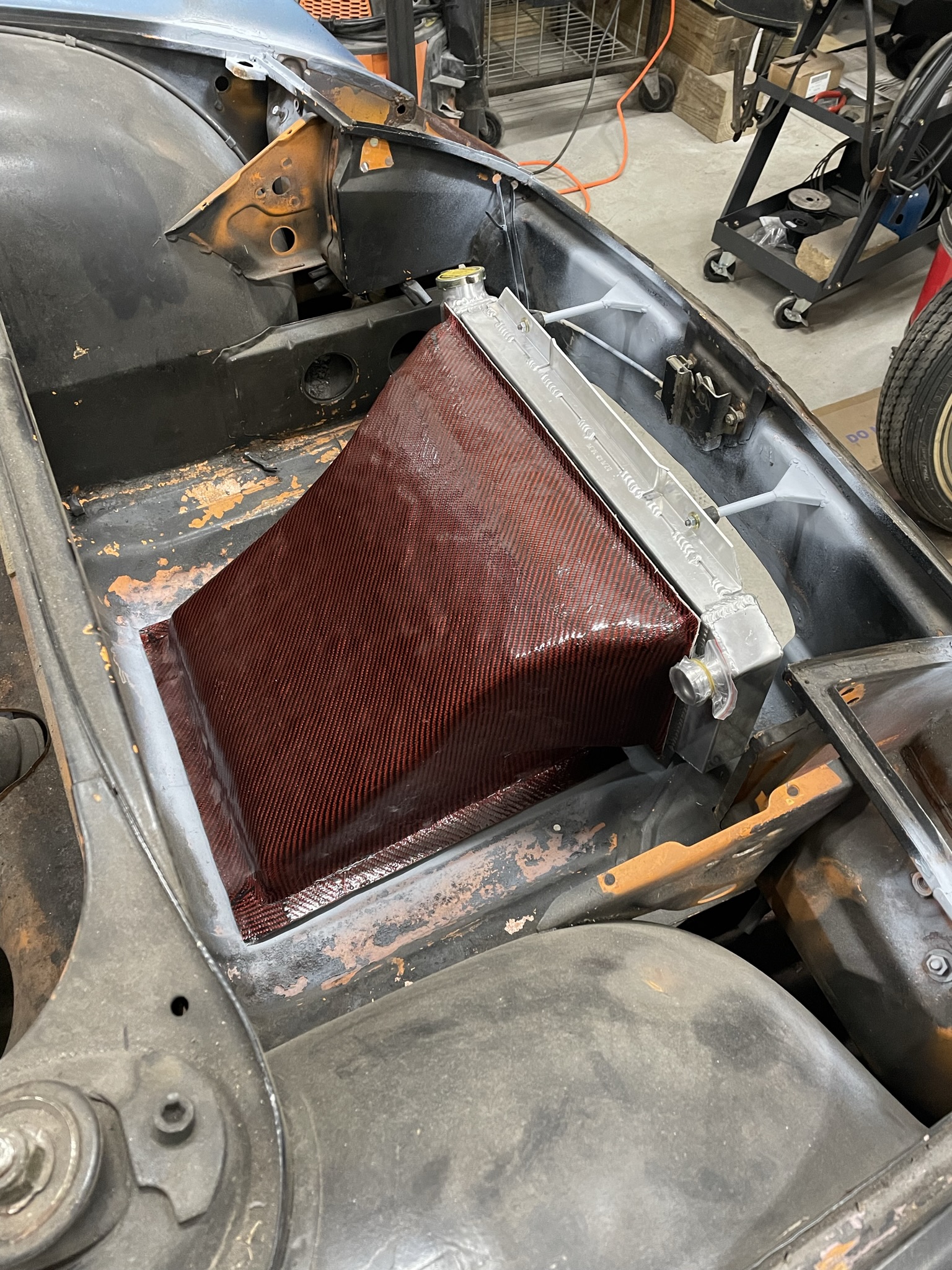

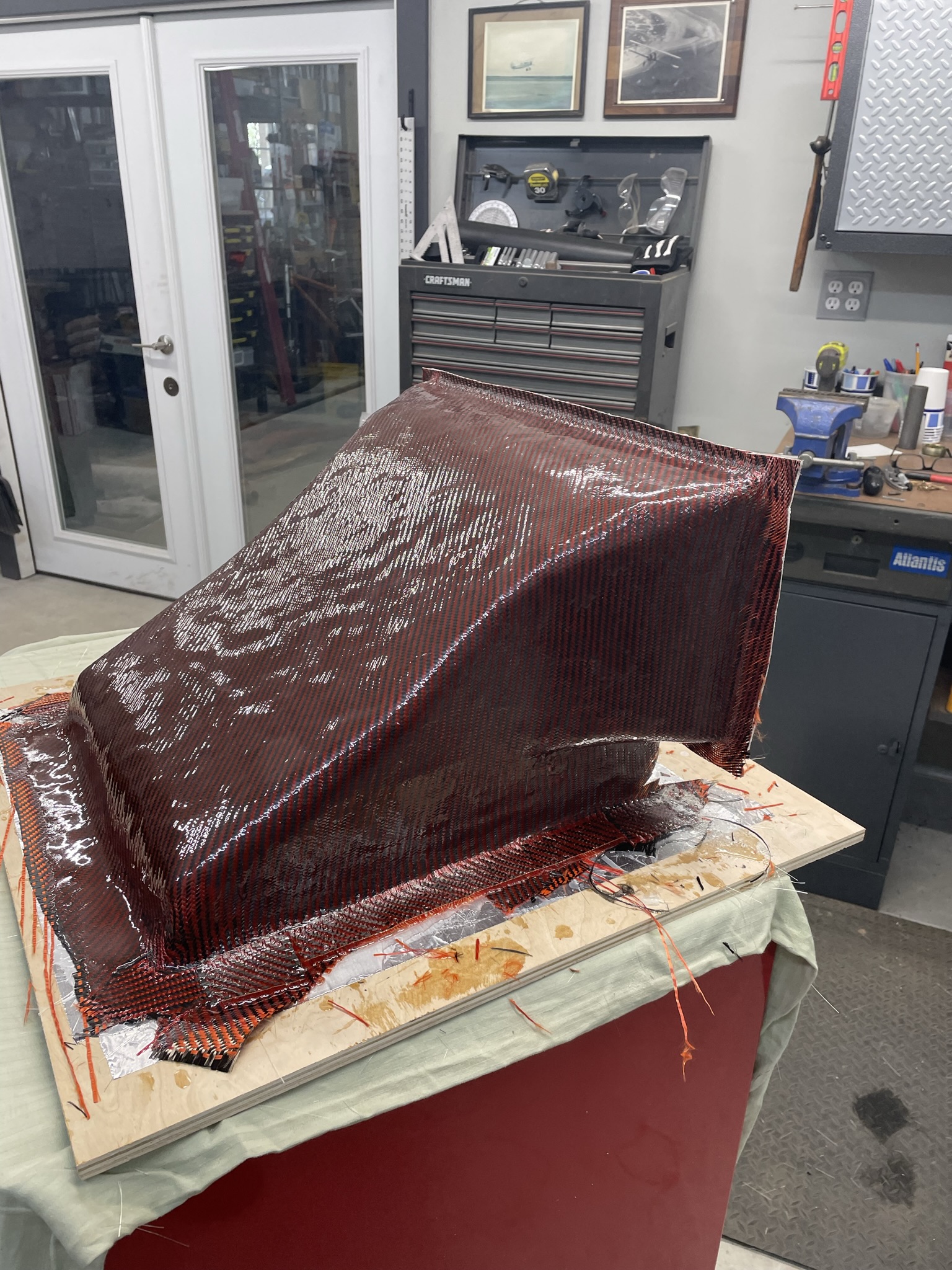

Montreal914   I am still in admiration with your fiberglass duct...   Dec 15 2022, 09:33 PM
East coaster   I am still in admiration with your fiberglass duc...   Dec 16 2022, 06:06 AM

slowrodent   Super metal fab work.. And that plenum is wondrous...   Dec 16 2022, 07:53 AM
Retroracer   Another nod to the excellent footwear - but adding...   Dec 16 2022, 10:35 AM
East coaster   Another nod to the excellent footwear - but addin...   Dec 16 2022, 07:35 PM
