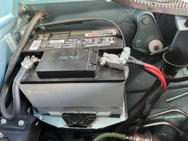

This is now available in Group 96R, just a tad smaller and should be in a drop in replacement for the original Group 42.

96R is indeed the drop In replacement and the Die Hard is also the private label manufacturer for Auto Craft sold through advanced auto parts.
