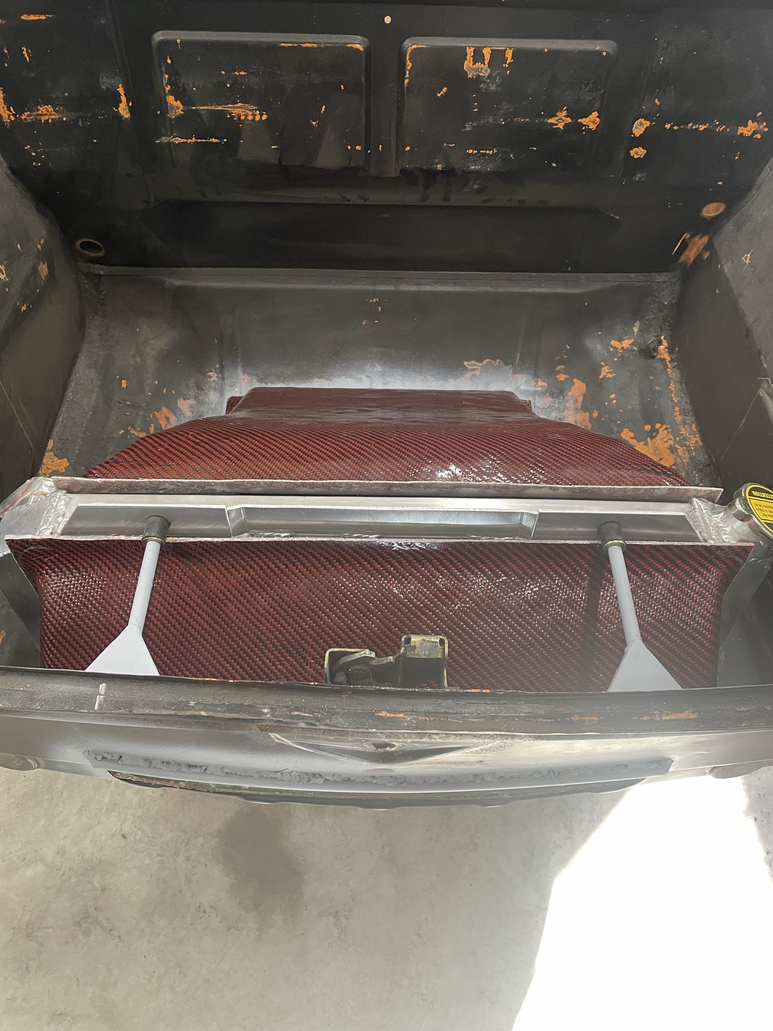

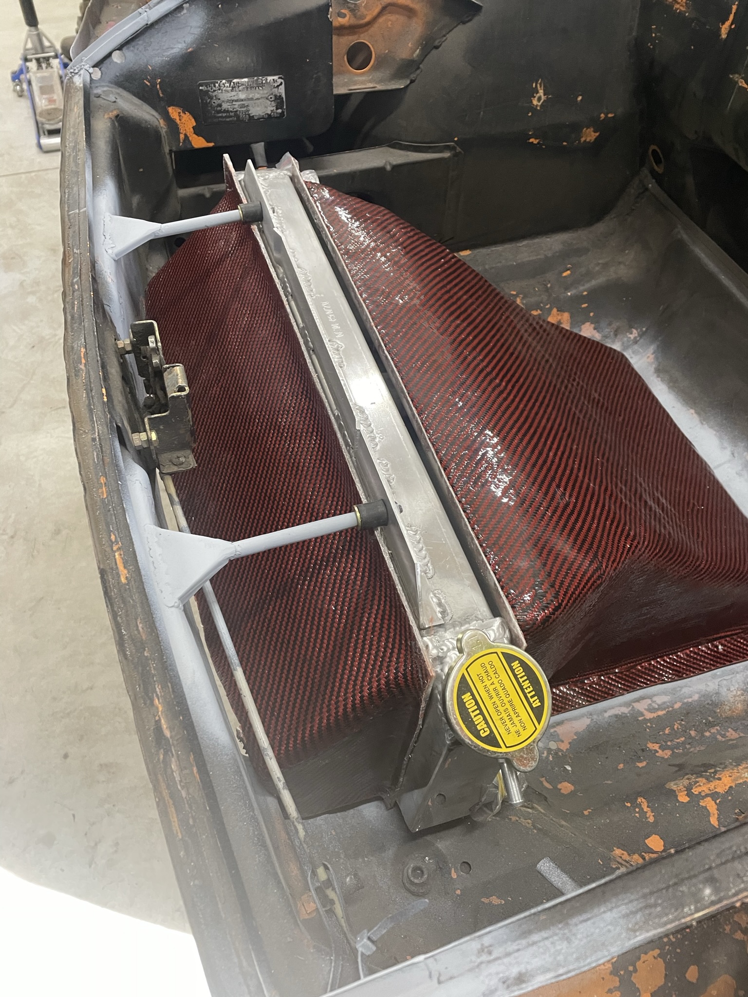

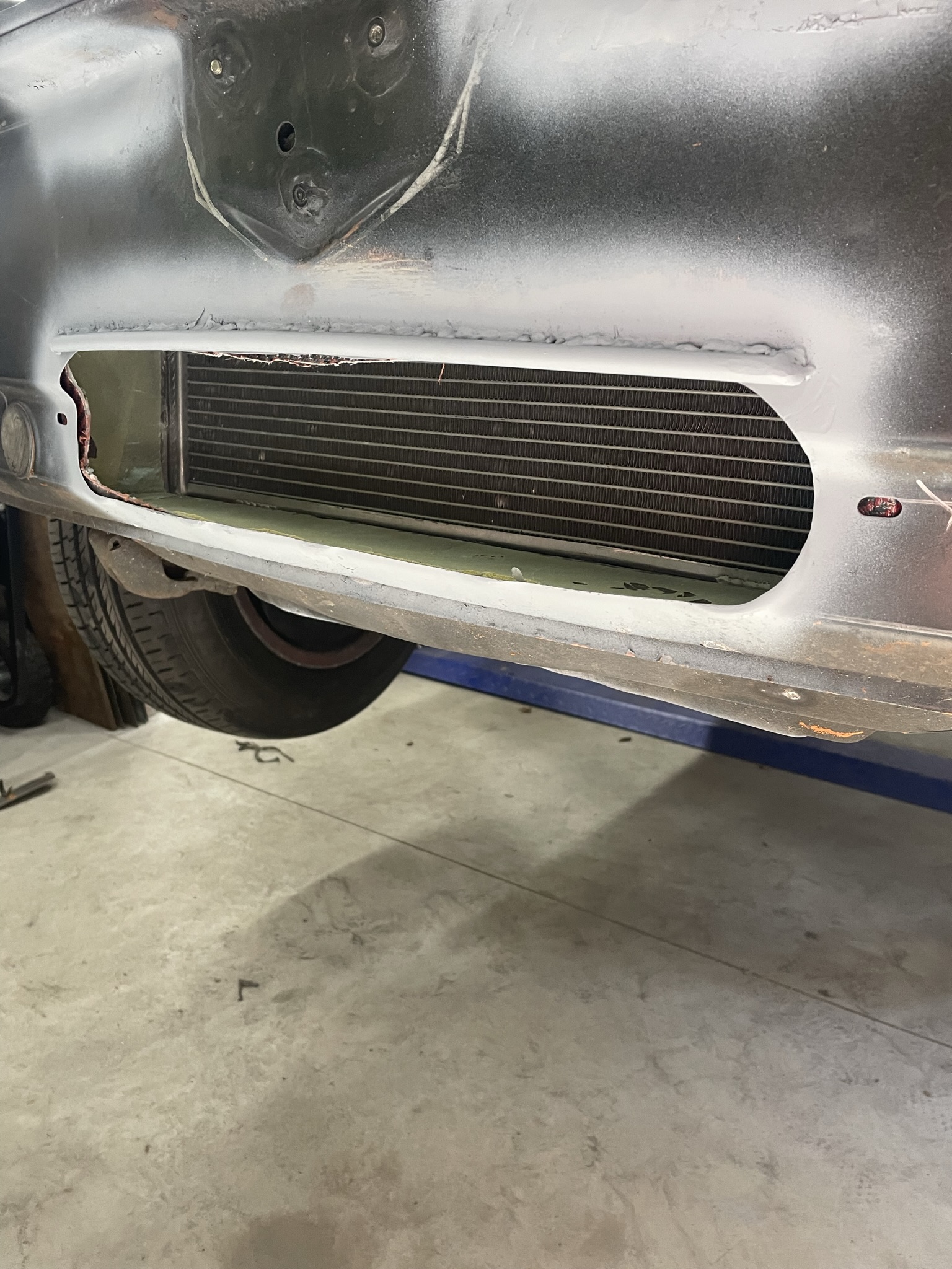

Finished up the entrance plenum. Final fitting/trimming will be held for final install, but it fits up pretty damn close now (leaving a little room for sealing). Now on to figuring out my cooling lines.
I added a piece of 1/4” chromoly tubing to the top of the radiator opening to stiffen things up a bit. It was pretty flexy at the top once the hole was cut.
