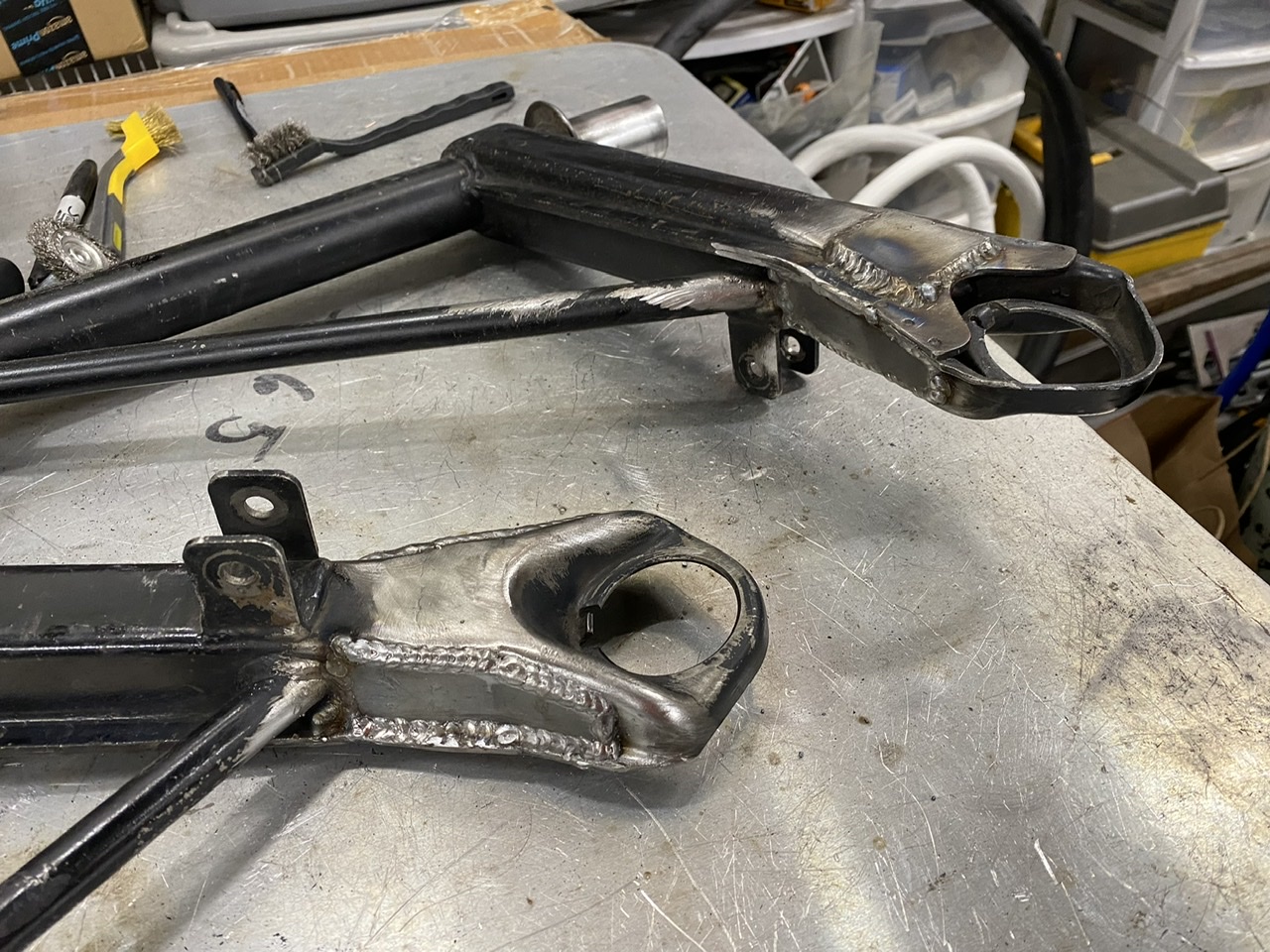

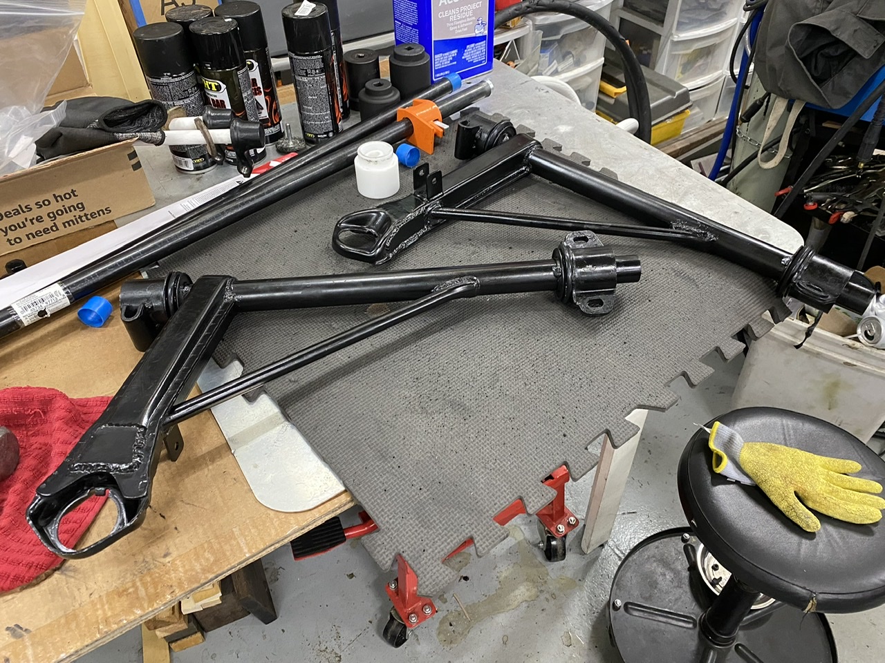

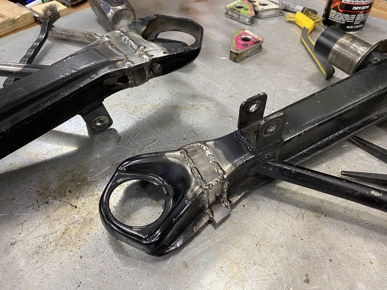

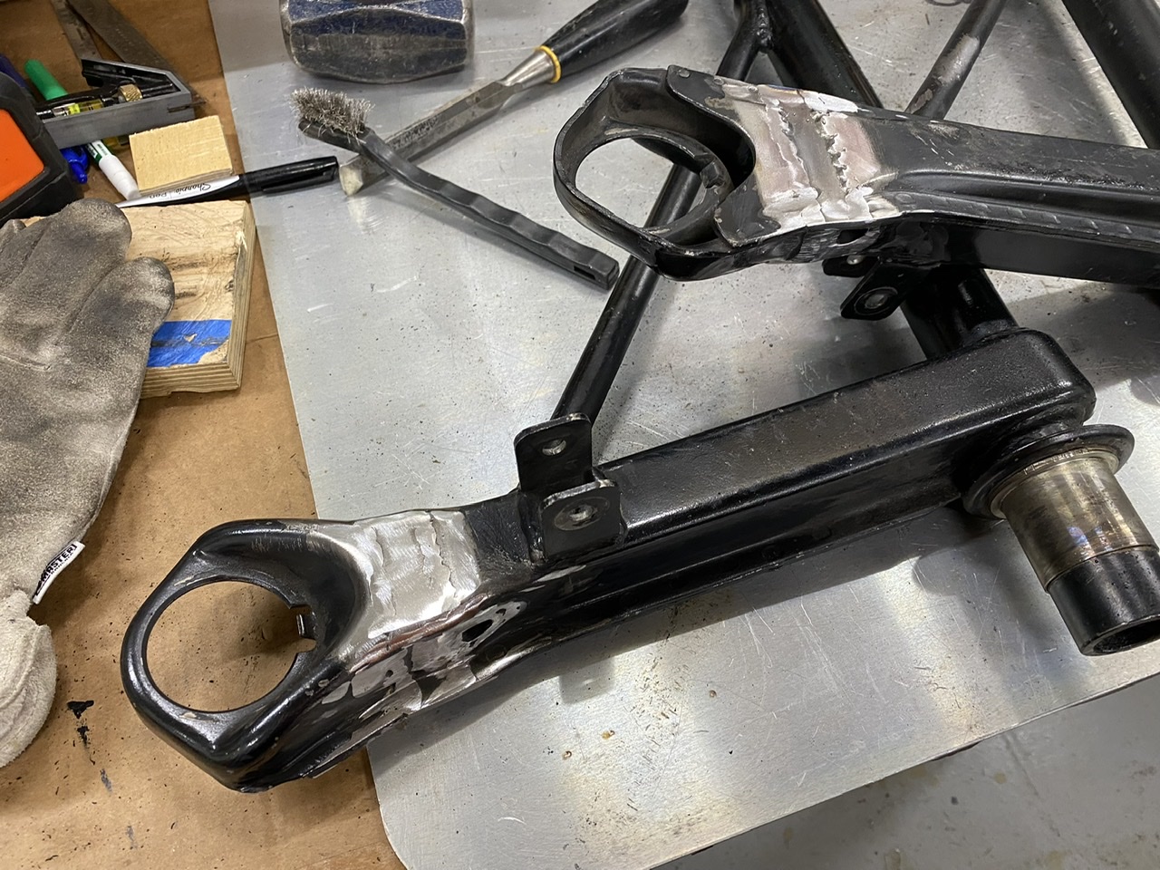

Continuing with the control arm extension..

waltonsm   Continuing with the control arm extension.. ...   Dec 21 2022, 08:10 PM

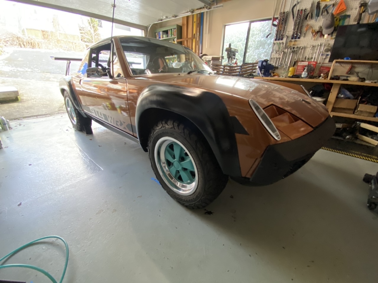

waltonsm   I got a few questions on fender install recently, ...   Feb 19 2023, 04:32 PM
