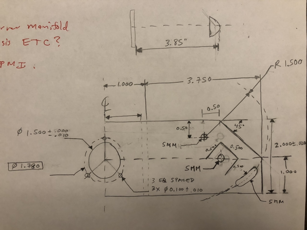

Turns out this is one of the least documented areas for me too. I will have to take more pictures when I get back after Christmas. But to get started, I found the smallest LED projectors I could find, below. One is aimed as a high beam, and one as a low beam in each side. I used a small hole saw to cut holes in the back of the turn signal bucket for them to pass through, and then I drilled holes in the sides to mount the stainless brackets I made.
The brackets were made from .030ish laser cut stainless, and then I bent them on the vise and welded some adjuster nuts/jack screws on. The provide the aiming degree of freedom needed.
I have a dozen ideas on how to redo/improve this in the future, but it is low on my list.
As we know, pictures (of the assembly) are worth everything, so you will have to use your imagination for a few days (IMG:style_emoticons/default/smile.gif)
