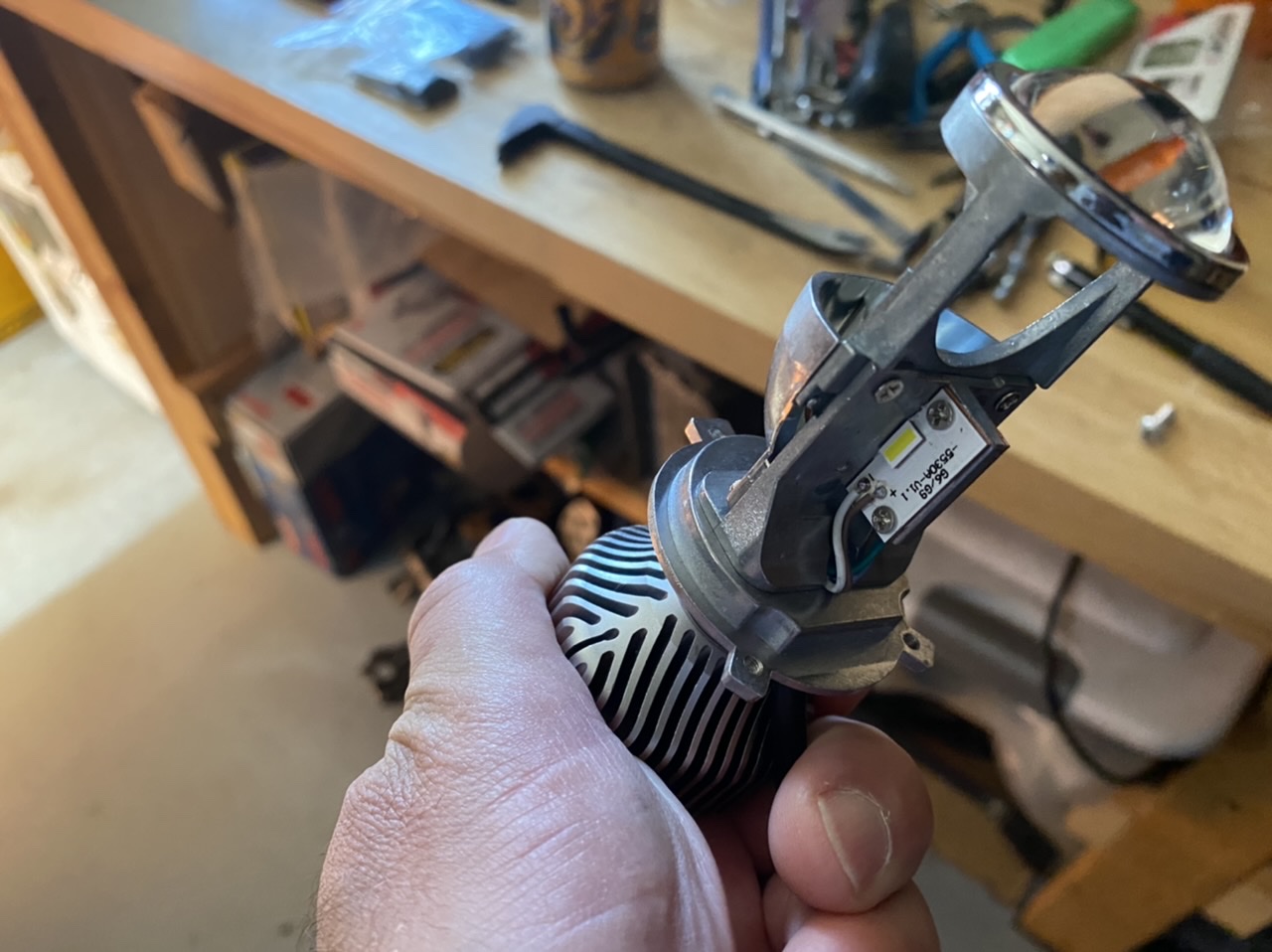

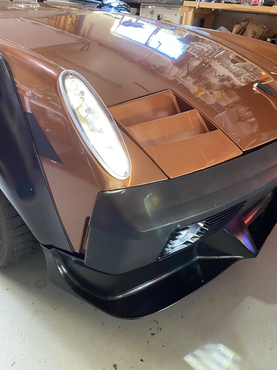

Turns out I found some photos from when I finally added the high beams.. bought everything initially, but ran out of time the first time around.
This will make more sense now. You can see the jack screws through the nut to hold the assemblies to the car. And the other bolts are for the pivot and lock for aiming up and down.
The fog lights are aimed about with my low beams. The high beams are daytime running lights I think. Bc Subaru body computer.
When low beams are on, I have fog and low beam, when high beams are on I have all three. Plenty of light and throw.
