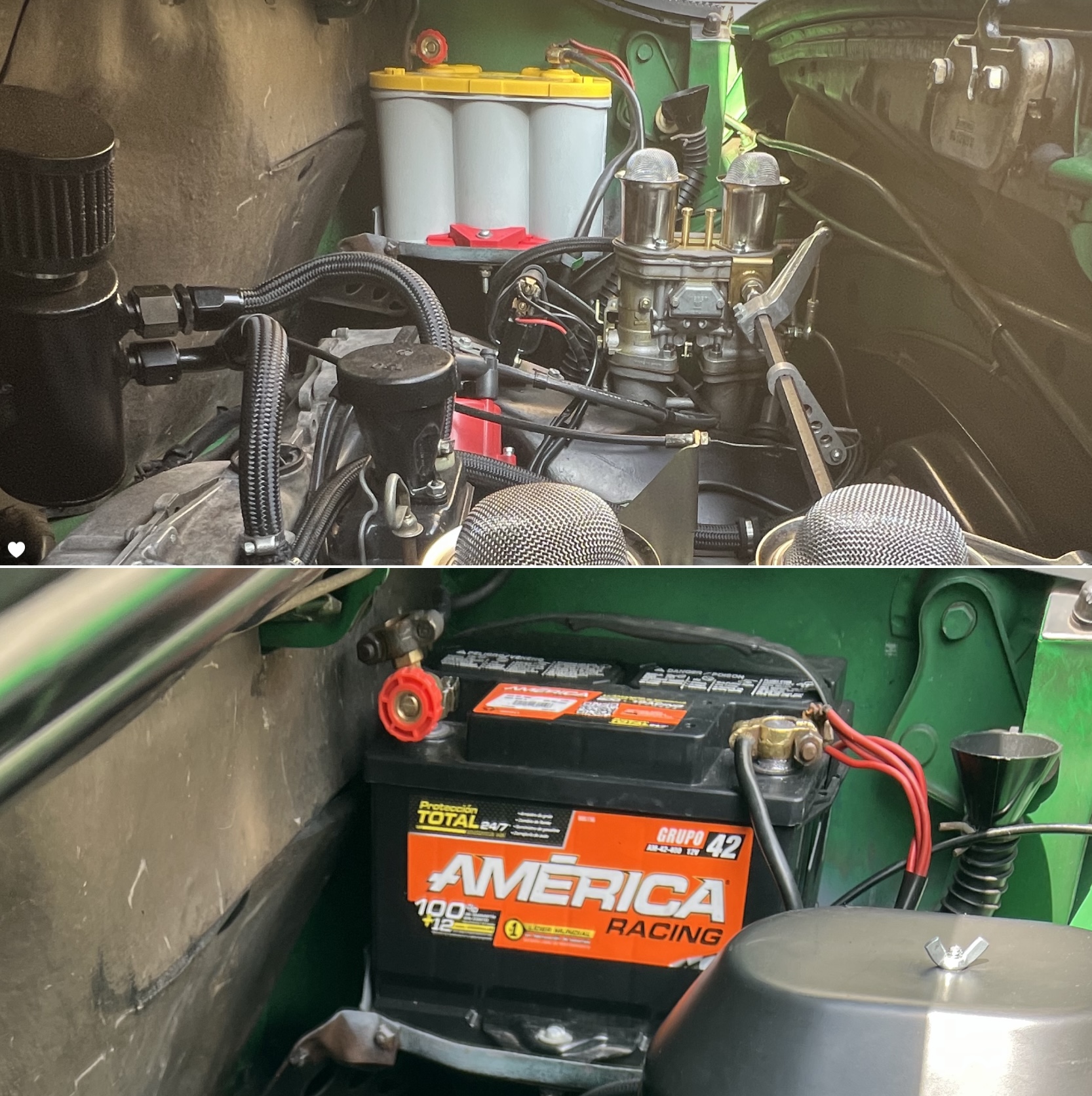

I used to have the specified type 42 battery, I have installed a CB performance coil, distributor and cable kit, and a tiny blaupunkt stereo, with no amp, and had big issues with the charge, I also burned a coil, don’t really know if it had anything to do, but eventually the 42 died. I now installed an optima yellow top, and since it all disappeared.
(Still Need some cleanup to do, please pardon my mess jiji)
