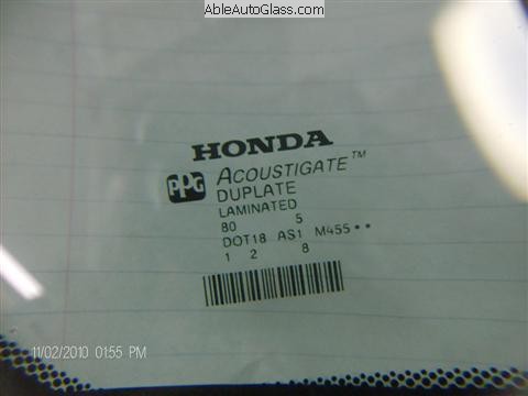

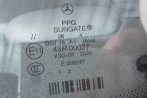

Unfortunately I can't. The codes all depend on how the manufacturer sets them up.
Since I worked at PPG I knew their system. DOT 18 was PPG.
Some of it was standardized... The M number defines the glass makeup and processing - I vaguely remember the M number had to be registered with UL or CSA as standards conformance testing had to be proven for the thickness, materials and processing of that configuration. Testing included ball drops, penetration, broken shard size, etc. US standards differ a bit from Euro.
AS1 mark defines the primary vision area - the windshield. AS2 is secondary vision areas like side and rear windows. AS3 would be for things like sunroofs. If the windshield has a blue / green tinted shade band at the top there will be an AS2 mark with an arrow on it, indicating it is not part of the primary area (they were also used in production for workers to line up the shade band of the laminated inner vinyl layer). The color was dyed into the vinyl not the glass.
This was made at PPG works no. 80 (Hawkesbury, Ontario) in November 2005.
This was made at PPG works 28 (Evansville, Indiana) in March 2004.
