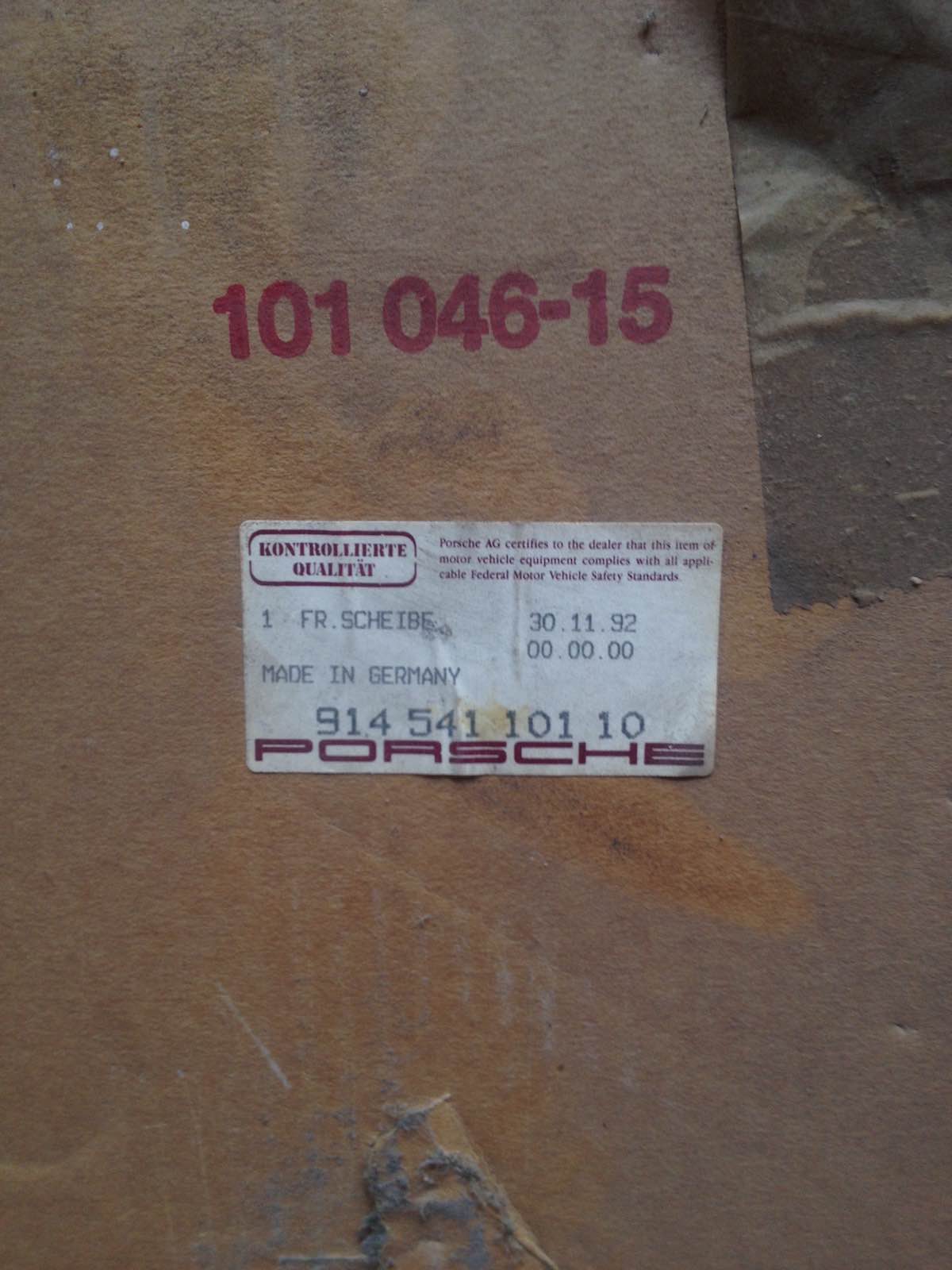

@JeffBowlsby
ok i just went back into PET on windscreens.
so there are 3 there that are clear.
one of them is indicated as being for 914/6 and for 2.0
one of them is indicated for being for 914/4, 1.7 and 1.8.
both have same part numbers. and why the difference. i mean there is none is there.
there is a third clear one.
this has again the same part # and specifically says not for USA, CND and S.
(canada and sweden)
and it says it is tempered plate glass. so there was one tempered or toughened windscreen. surprising to me. but in looking closely not so surprised. PET describes other three as laminated. but makes no mention of laminated for this one. i don't think its laminated. its one single sheet of glass. if it is then i can understand how its been made. its been formed and then its been tempered. thats the only way you can do it.
what it is saying Jeff is that tempered screens are not for the USA. definitely not a USA standard. so i will bet a 1000$ that that screen whatever it is does not have AS1 written on it?
and then the fourth one is the heat protection glass.
and its the one with the different part no.
it is described additionally as laminated.
so there will be three with laminated written on the screen.
the toughened or tempered one will probably not say laminated anywhere on it.
the spare one i have in the box is the commonly shared part number that three of them have. 914 541 101 10. lucky i have it still in its box because i can at least link a screen to a part #. its on the box. no other way to do it as no part # on screen itself.
going to be interesting when i get the screen out and see whats on it.
but not going to rush into that. i need a friend around here to help me get it out carefully. whatever it is though part # says its clear (and one of the versions of the clear).
i've got my fingers crossed its not a f$%ken tempered one. last thing i want as a spare. (IMG:style_emoticons/default/sad.gif) (IMG:style_emoticons/default/blink.gif)
i don't think it will be as i am pretty sure its got to be lam glass for australia, and i don't believe the aus distributor would have been that stupid. they used to know what they were doing. but you never know. i'm really going to have to have a look at it now.
