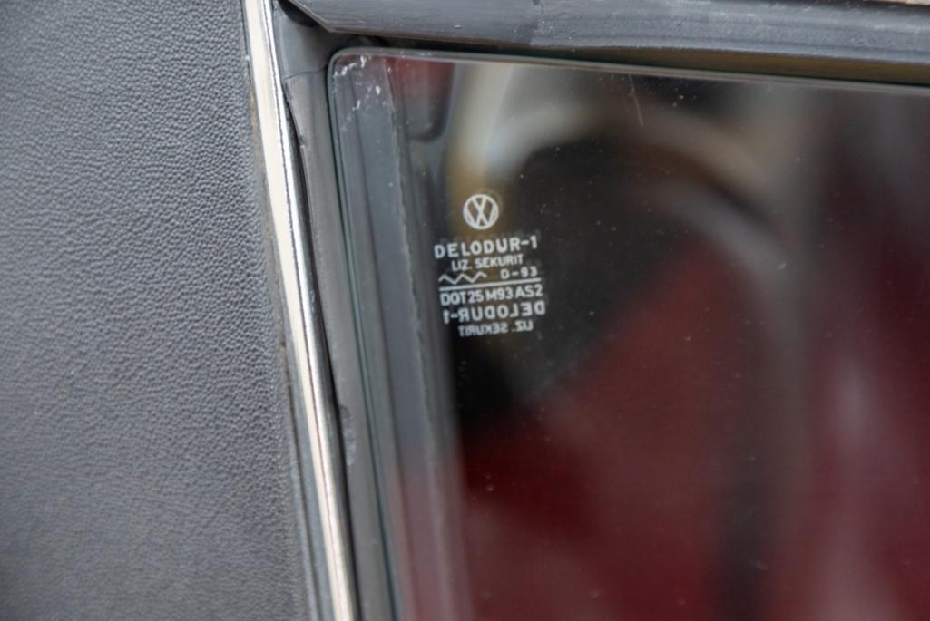

Looking for help if anyone makes these OEM Windshield Sticker's?
Are they different for every model year?
Many years ago while restoring my 914 I used a solvent to clean up the windshield glass & destroyed the letters. I would like one for my OEM original windshield (IMG:style_emoticons/default/pray.gif)
This is off as recent 1976 in a local shop for repairs in this photo.
Tom Michigan

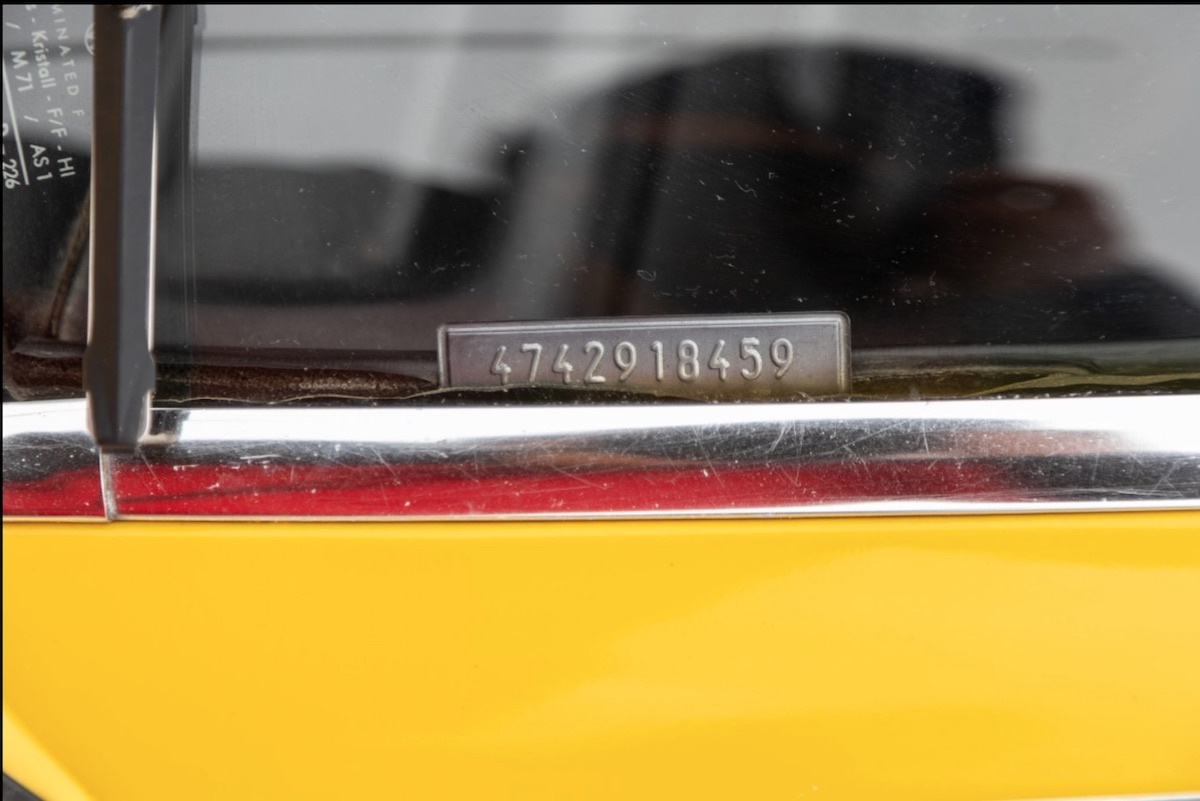

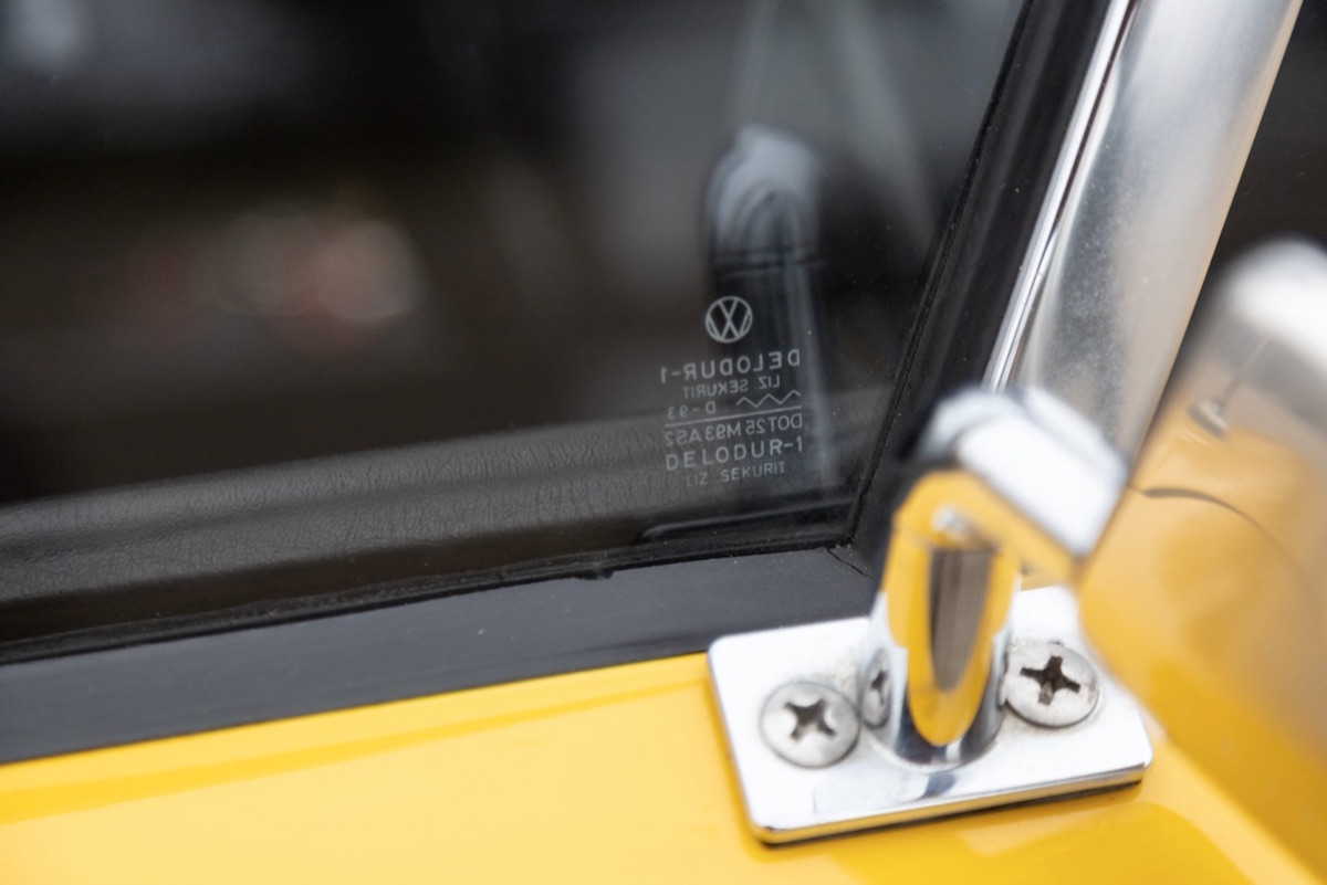

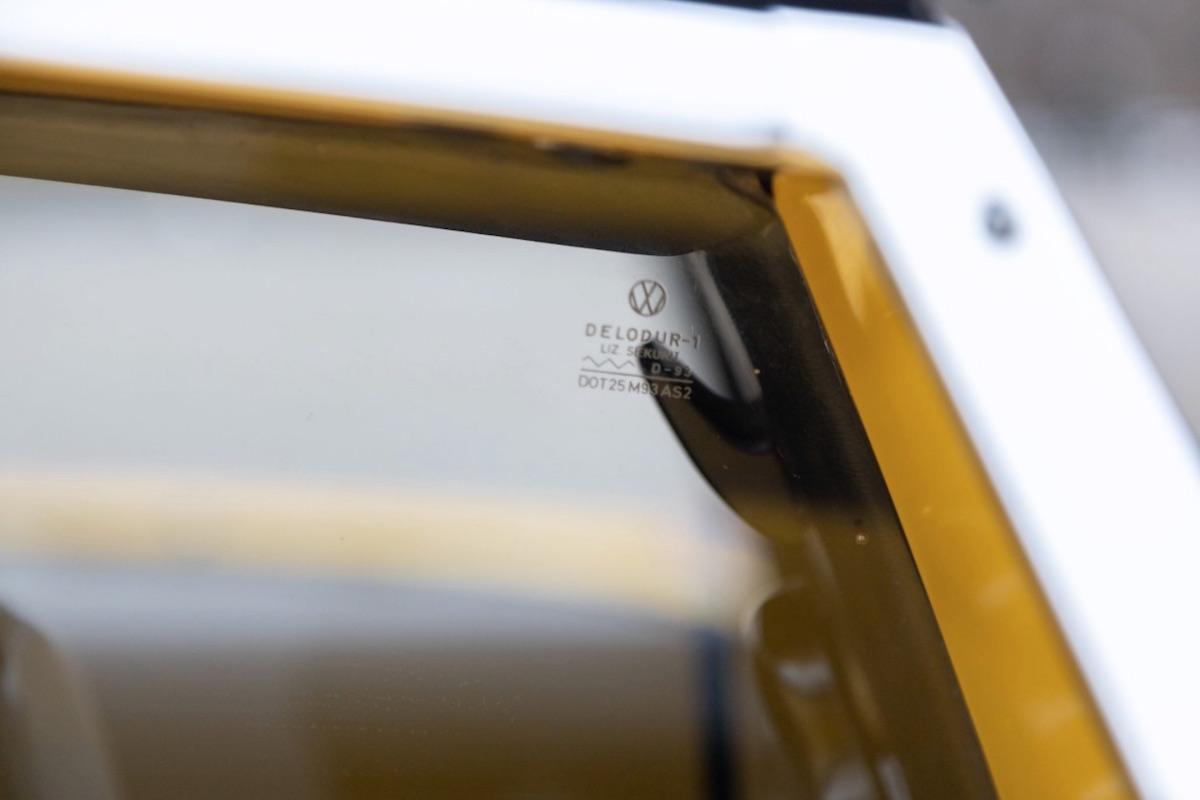

so this is the late 74 2.0 that was on BAT and very original car.
its a MAY 74 build. i just checked.
all the glass matches mine.
thinking this is your "non tinted" standard glass package.
but no CofA. or window sticker.
similar predicament to me.
i think what happens on BAT is people use the CofA or window sticker as a prompt.
they reference the option list and then go photograph everything that is an option to tick it off for originality. so "tinted glass" as an option prompts them to photograph all the glass. whereas your standard package doesn't prompt sellers to photograph glass.
hence i can't seem to easily find a nice neat CofA or sticker link up with the package of glass in the yellow one or mine for instance. spewing now original owner never kept that sticker. could get CofA but its a pretty dumb process these days and not worth doing.

vitamin914   I was a tooling engineer at PPG in the late 80s. ...   Jan 5 2023, 04:06 PM
