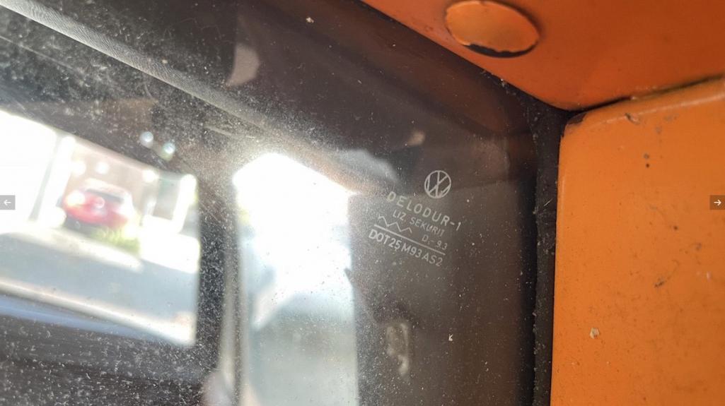

vitamin914   I was a tooling engineer at PPG in the late 80s. ...   Jan 5 2023, 04:06 PM
JeffBowlsby   Interesting. Can you decipher the date or date co...   Jan 5 2023, 04:41 PM
wonkipop   Interesting. Can you decipher the date or date c...   Jan 5 2023, 07:10 PM
vitamin914   Interesting. Can you decipher the date or date c...   Jan 6 2023, 08:02 AM

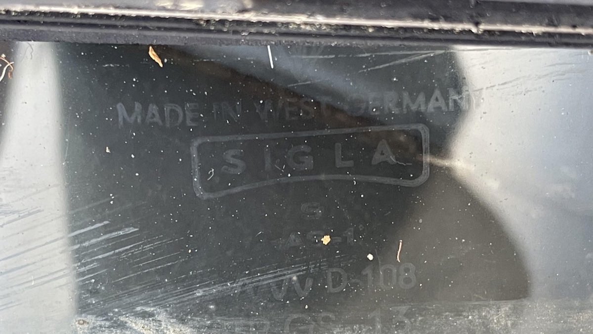

JeffBowlsby   The ziggy-zaggy line is the Sigla logo.   Jan 5 2023, 08:30 PM
wonkipop   The ziggy-zaggy line is the Sigla logo. just to...   Jan 5 2023, 09:04 PM
wonkipop   @JeffBowlsby . i have a feeling (hunch) but could...   Jan 5 2023, 09:21 PM
wonkipop   here is how you tell who made the windscreen. its ...   Jan 5 2023, 11:48 PM
vitamin914   the weird logo in the sudglas screen is not a...   Jan 6 2023, 06:20 AM

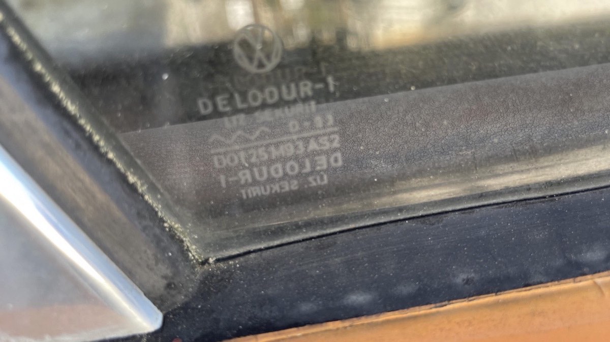

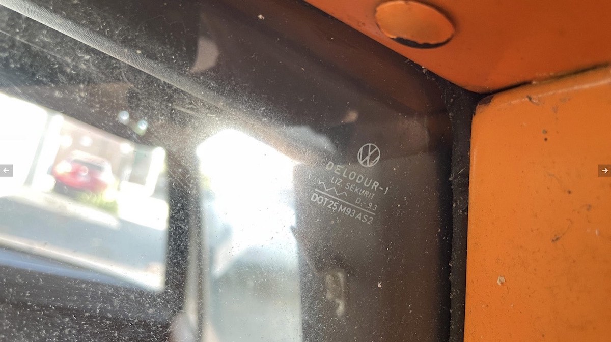

wonkipop   @JeffBowlsby re tough v tempered. down here we...   Jan 7 2023, 04:09 PM
wonkipop   @JeffBowlsby i had a look at the car on BAT you ...   Jan 7 2023, 04:33 PM
wonkipop   to explain a little further about the front screen...   Jan 7 2023, 05:41 PM
wonkipop   @JeffBowlsby getting a bit closer on the DELODUR...   Jan 7 2023, 06:49 PM
