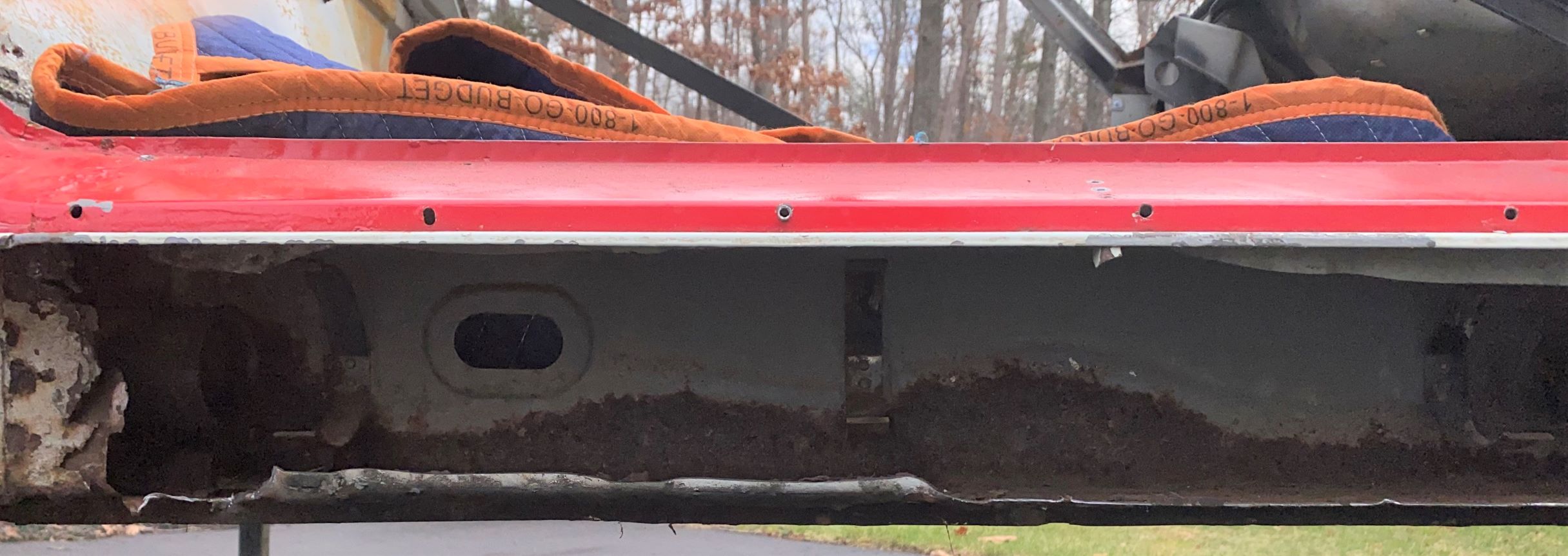

Tom1394racing   Since my last posting, the external longs were ope...   Jan 11 2023, 03:25 PM

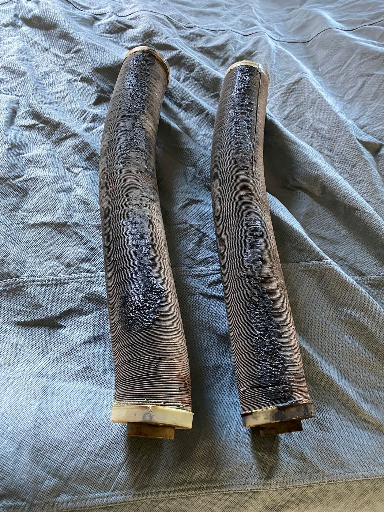

Tom1394racing   Inner longs don't look too bad and the heater ...   Jan 11 2023, 03:29 PM

Tom1394racing   Here are some examples of the nasty hidden sins th...   Feb 28 2023, 04:02 PM
