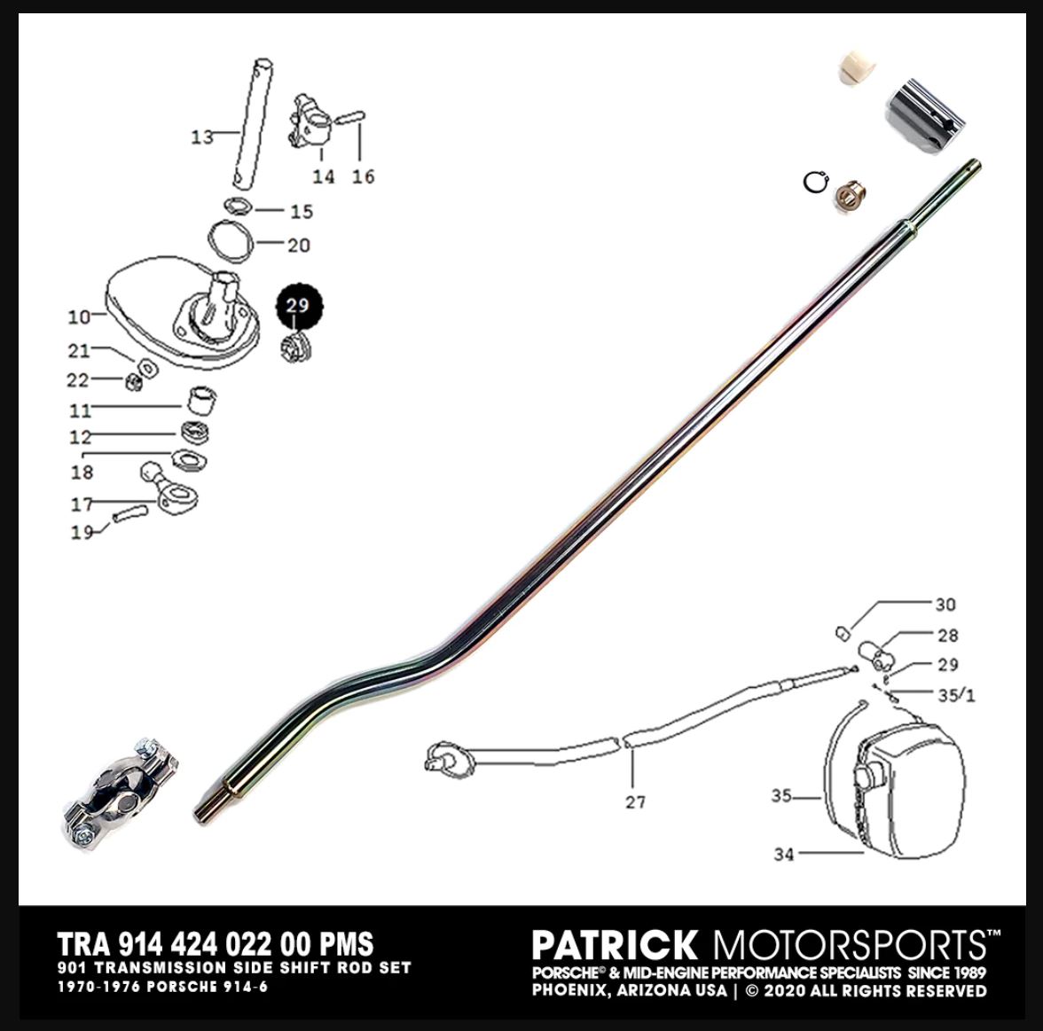

Here is an exploded view of the assembly (found on Patrick Motorsport website).
#20 is the o-ring that seals the console to the gearbox housing and #15 edit #12 is a lip seal that seals the shaft to the console. To replace the lip seal, you need to remove pin #16 or 19 to be able to pull out the shaft from the console assembly.
AFAIK, there is no difference in any side shifter gearbox years.
Good luck with your repair! (IMG:style_emoticons/default/smash.gif)
