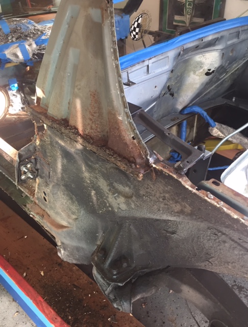

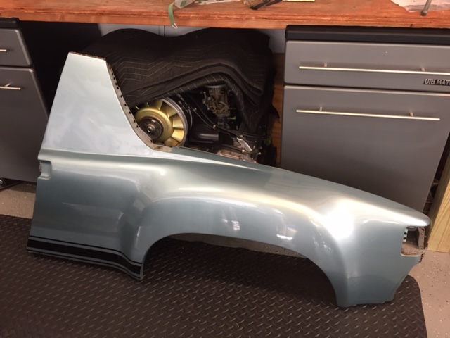

Well being a bit crazy and on the advice of a fellow 914 restorer, I’d remove the quarter panel again. It allowed so much access to address my cars issues.
Granted it took a day to remove all the spot welds. But glad I did.

QUOTE(Dion @ Jan 17 2023, 12:20 PM) *
One of those things......
We are spending sooooo much time cuttin rust out and cleaning the car up what is a day to pull off the QP and another week putting it back on. (IMG:style_emoticons/default/smile.gif)
Appreciate your insight!
