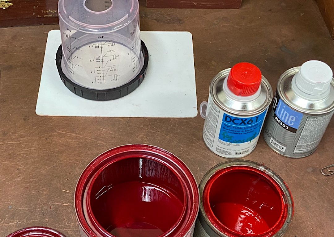

Comparison between two brands PPG (on left) vs Sikkens (remnant from original paint on right) and pre EPA (Sikkens) vs reformulation of VOC and pigments (the PPG)
Both are supposed to be same color code BMW #138 - model year 1991
I had better luck having PPG do a color match to a painted / faded headlamp cover which actually came back as Honda R90 (a motorcycle color I think). I had the R90 mixed and I think it actually was a better match when sprayed.
Just be aware that no matter what you have mixed it probably won’t match 100%.Attached Image
