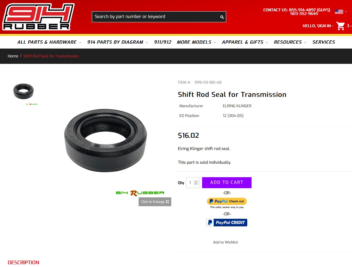

I have a side shifter that leaks at the console.
I cold drip every hour…
I bought the transmission gasket set from pelican
There is nothing in the set for the shifter console….nada
I removed the console
It looks like there is a bushing at the bottom.
Does anyone have a clue on part numbers to order to rebuild the shifter console?
It’s a 75/76 if that matters.

Got what you need
https://914rubber.com/shift-rod-seal-for-transmission
