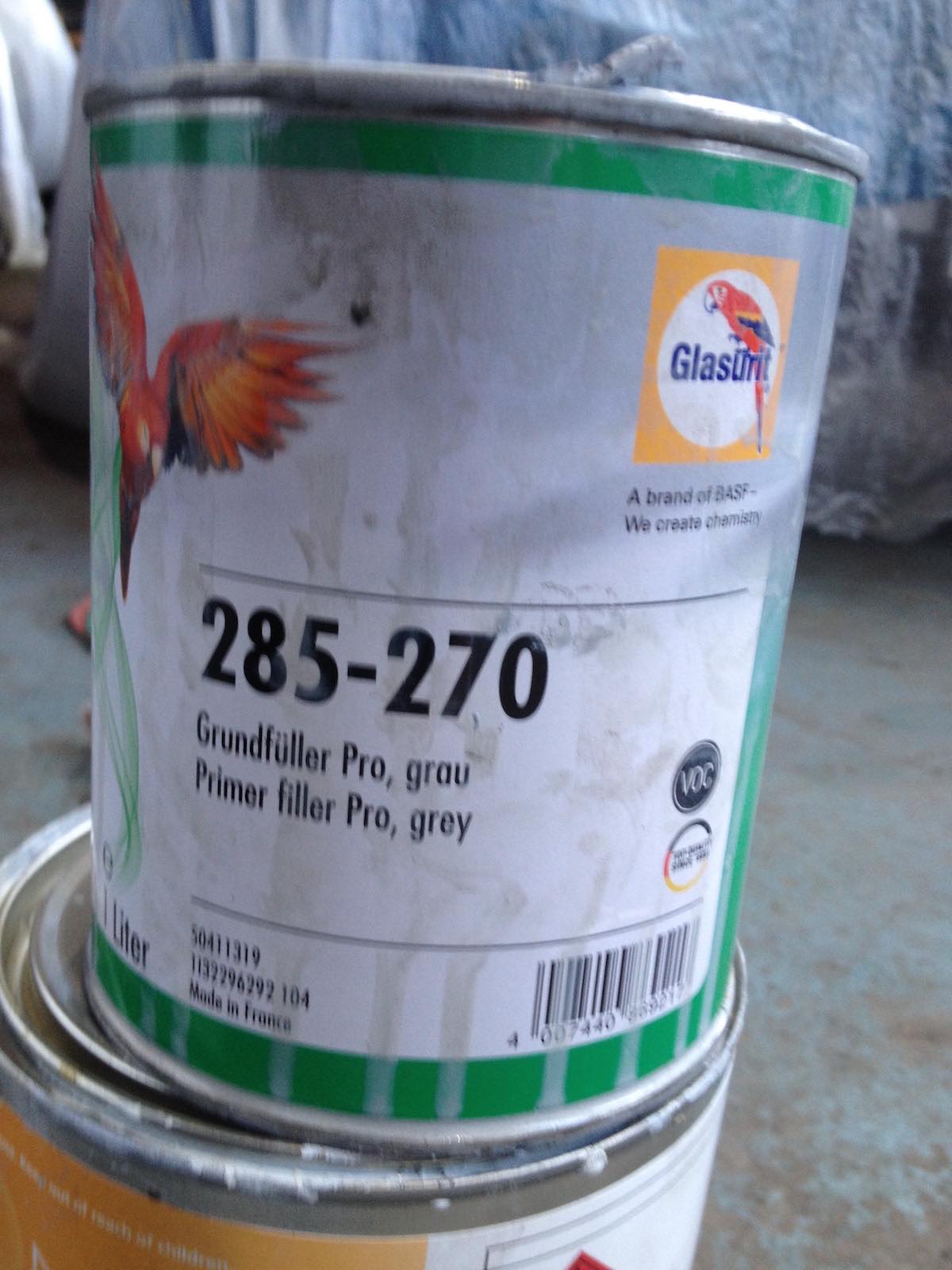

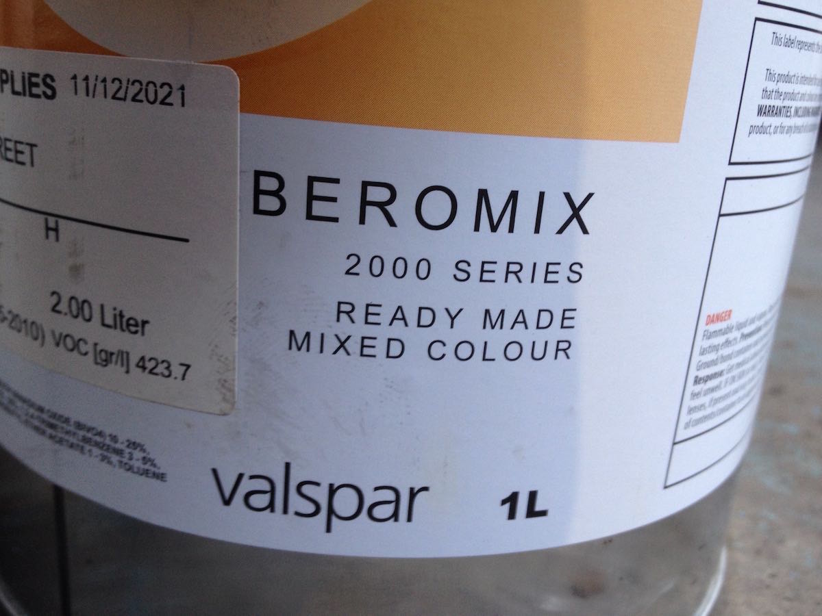

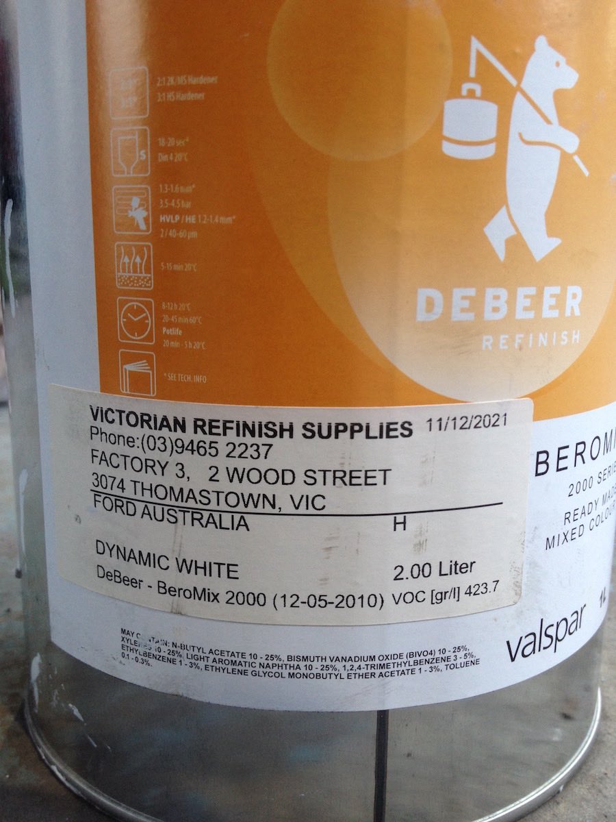

this is what the old falcon ute got.
wouldn't mind hearing @Superhawk996 views.
(its a perfect match, as it turned out, it was adjusted slightly, we took a door down and had it matched, compensated for fade etc). not over the top paint given the ute is just a ute. but good enough not to make for a rubbish job.
i've got to say i love block sanding this primer.
i only do prep.
had nothing to do with the 30 minutes of glory at the end.
i read a thread a while back and i think @Superhawk996 expressed severe doubt about this product. oh well. (IMG:style_emoticons/default/sad.gif) (IMG:style_emoticons/default/smile.gif) the falcon is doomed.

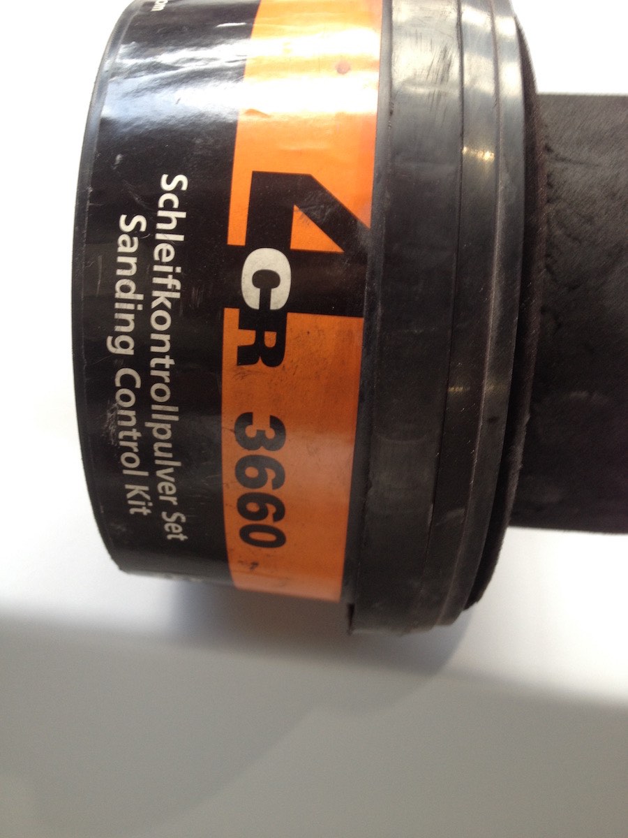

Superhawk996   No doubts about the product(s). BASF has been aro...   Jan 19 2023, 06:54 AM
wonkipop   As far as the guide powder - no doubts that it w...   Jan 19 2023, 02:57 PM
