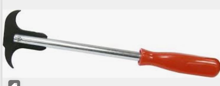

Maybe use a seal puller? Runs less risk of damaging anything.

Great idea, but waay to big. It's possible there is a tiny version out there. I may heat the aluminum housing slightly. "Gentle prying" with a screwdriver doesn't move it
